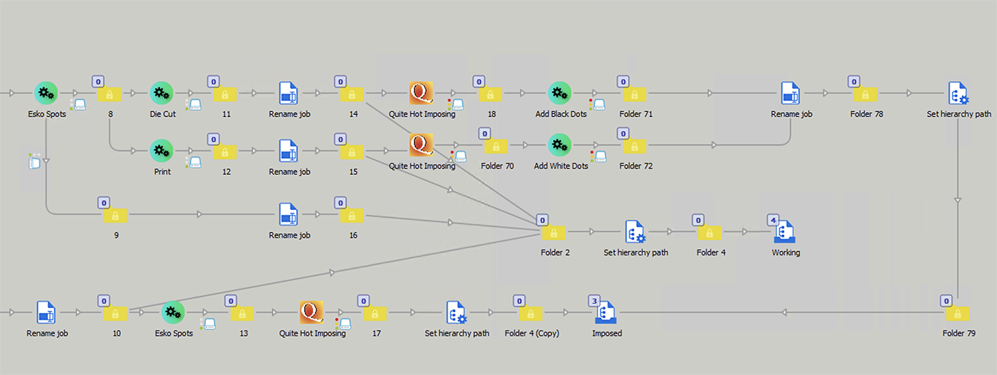

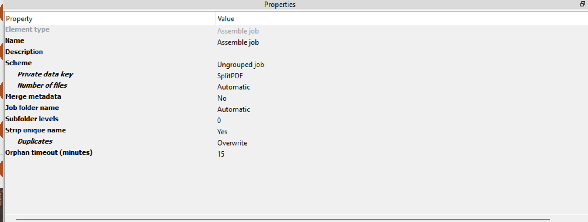

The files are split by certain pages, then re-combined and text added to the end of the file name.
Screenshot 2024-02-09 at 16.29.28.png (231.08 KiB) Viewed 11700 times
Screenshot 2024-02-09 at 16.28.49.png (217.8 KiB) Viewed 11700 times

What step in your flow are you creating the folders, and if you are using an assemble what are the properties you have set in them?

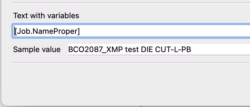

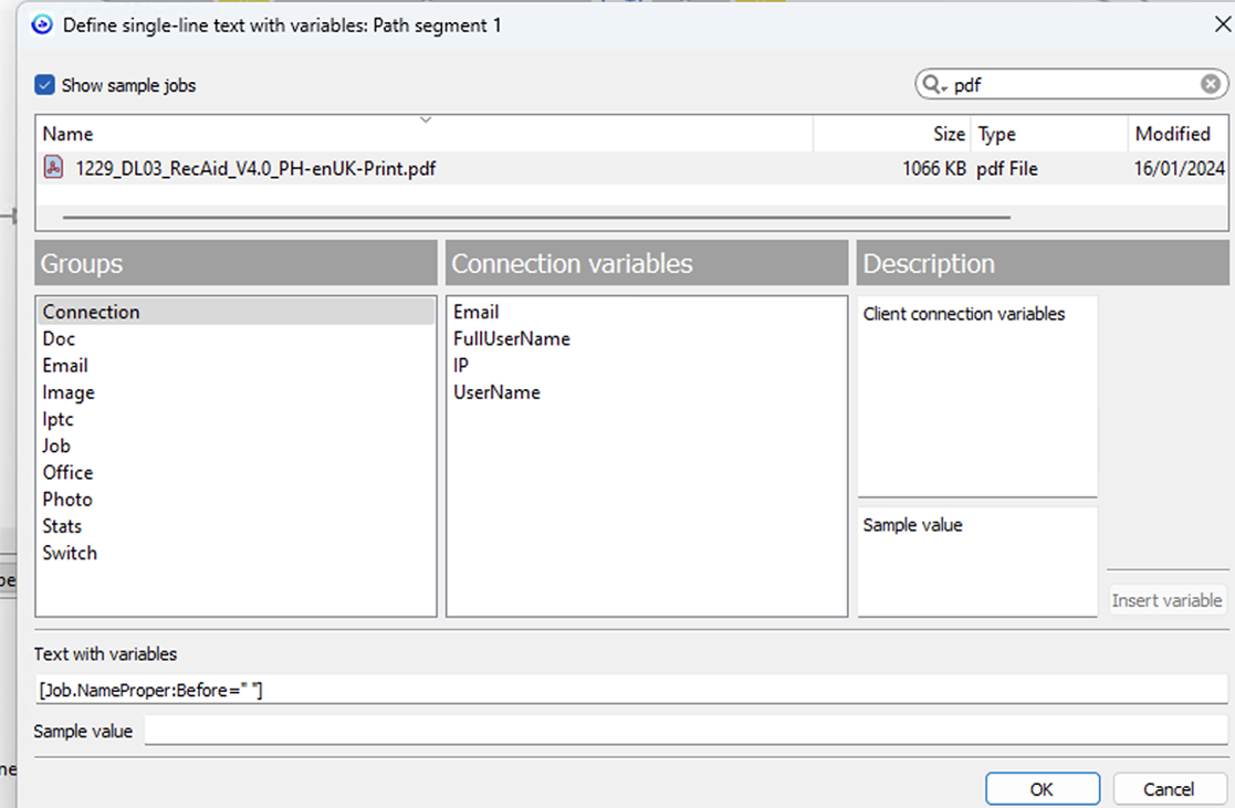

attached
Screenshot 2024-02-09 at 19.26.02.png (207.56 KiB) Viewed 11687 times
Screenshot 2024-02-09 at 19.22.23.png (170.08 KiB) Viewed 11687 times
Screenshot 2024-02-09 at 19.21.16.png (245.59 KiB) Viewed 11687 times

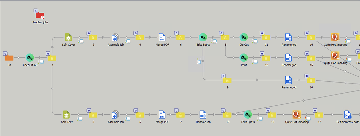

I can only ask what rhd_ole was asking for, just a bit rephrased: as of where in the flow is the name wrong? Is it only at the end of the flow (Archive hierarchy) that the name is wrong, or is it somewhere along the route and at what point exactly?
If you are OK with that, it is better to export the flow, zip it and share that than to share screenshots that may be showing settings that have nothing to do with it. To make things easier for those who want to investigate this, remove the steps that process the files without changing the names (PitStop Server and Quite Hot Imposing).

Flow attached

Just trying to follow this more. So you are looking to put the files that come out of the rename jobs, that go through the Set hierarchy path into your Working folder in a folder with the same name as the file?

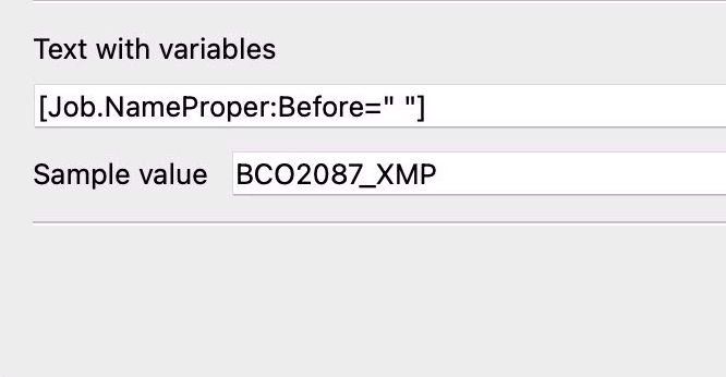

If so, you Set hierarchy was before the space in the name so it was using just that to name the folder and not the entire Job.NameProper. I updated the variable in the set hierarchy and they all seem to be one folder named the same as the file.
You can see in the attachements
Old variable -
Screenshot 2024-02-12 at 5.18.59 AM.png (52.38 KiB) Viewed 11524 times
New variable -
Screenshot 2024-02-12 at 5.19.10 AM.png (60.44 KiB) Viewed 11524 times

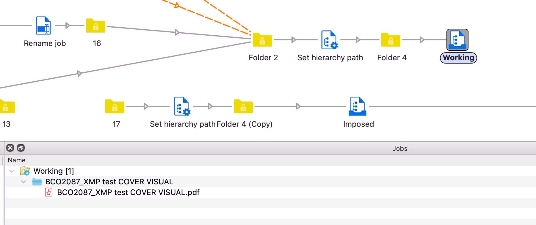

Result in folder -
Screenshot 2024-02-12 at 5.16.48 AM copy.jpg (124.6 KiB) Viewed 11524 times
