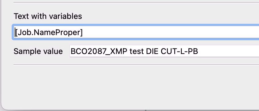

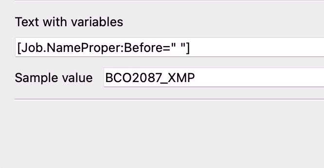

Just trying to follow this more. So you are looking to put the files that come out of the rename jobs, that go through the Set hierarchy path into your Working folder in a folder with the same name as the file?
If so, you Set hierarchy was before the space in the name so it was using just that to name the folder and not the entire Job.NameProper. I updated the variable in the set hierarchy and they all seem to be one folder named the same as the file.
You can see in the attachements
Old variable -
Screenshot 2024-02-12 at 5.18.59 AM.png (52.38 KiB) Viewed 11533 times
New variable -
Screenshot 2024-02-12 at 5.19.10 AM.png (60.44 KiB) Viewed 11533 times

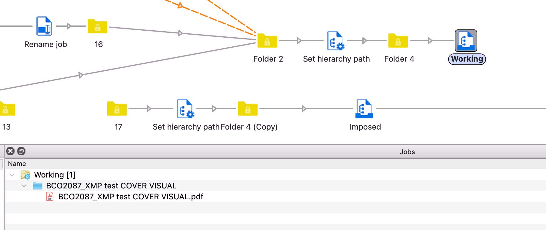

Result in folder -
Screenshot 2024-02-12 at 5.16.48 AM copy.jpg (124.6 KiB) Viewed 11533 times
