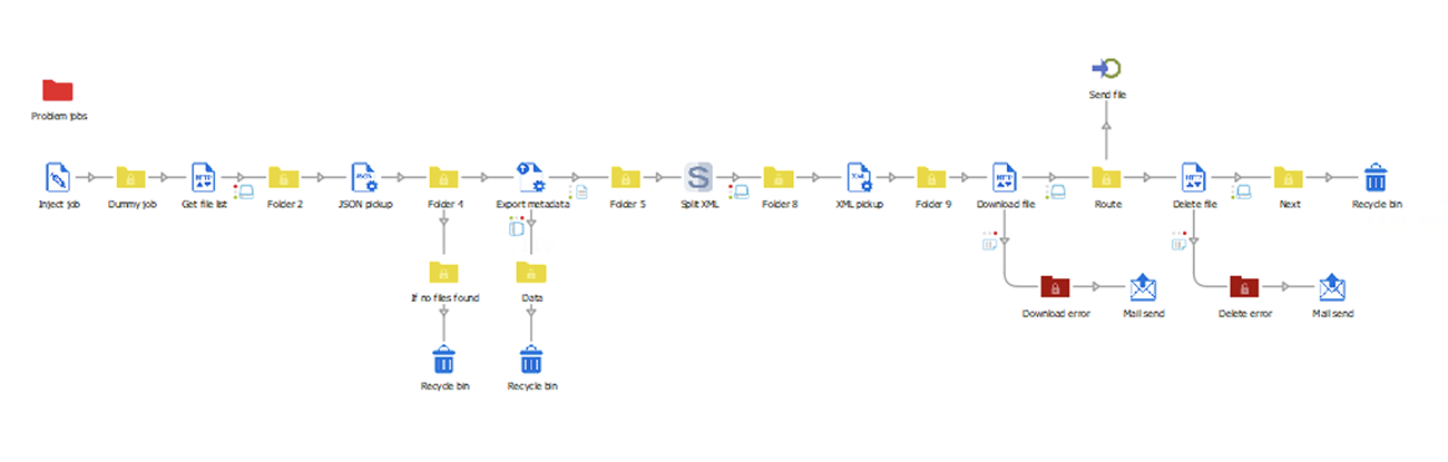

I solved it this way:
1. Pickup JSON as Legacy app XML
2. Export meta data as XML file
3. Saxon with a simple XSL to split the XML (one per filename)
4. XML pickup
5. HTTP request

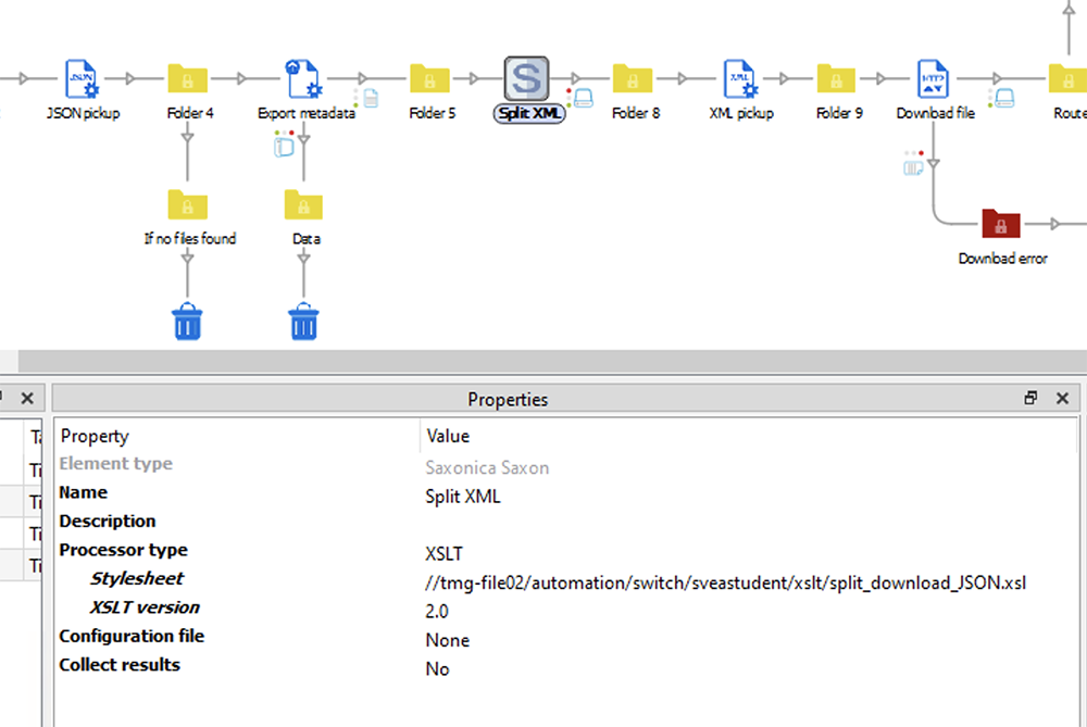

First I installed Saxon 9HE using Chocolatey (choco install saxonhe). Then I installed the Saxonica Saxon Switch app.
In the Saxon app element you just need to choose the xsl-file that you want to use for transforming the incoming XML.
