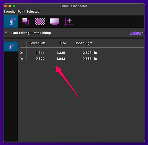

Thanks for the reply! I'm still having trouble though.
When I highlight the node, the Info palette displays the cooridates of the node, but none of the fields are user-fillable. I can't seem to alter the coordinates. When I try the "position" tab (the far right tab at the top,) it changes the position of the entire object.
I can't figure out what I'm doing wrong :)
Screenshot 2024-04-26 at 8.36.54 AM2.jpg (39.37 KiB) Viewed 14341 times

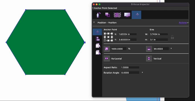

You need to go to the Position Pane:
But this is tricky, you need to edit width/height to "move" the point. If you edit x/y, you actually move the whole path.

Thanks for the reply! It's still not working though.
Here's a gif that shows what it's doing. I'm in the "Position" tab of the Info Palette. I selected the far right node of the Hexagon shape. The Info palette says "1 Anchor Point Selected," and the Node is highlighted. When I enter "-0.5" inches into the Width field to move the node, the entire shape scales down instead of only moving the selected node.

My bad, indeed it changes the whole path. Can you develop more on your need for tweaking nodes position?
