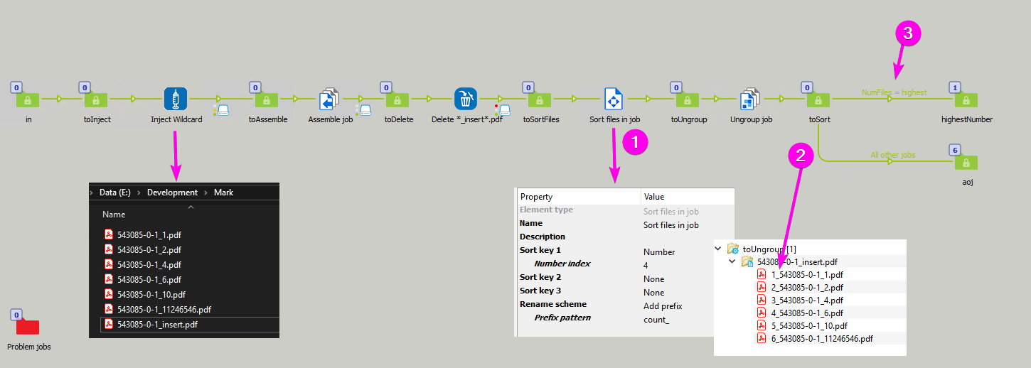

Posted: Mon Jun 03, 2024 4:39 pm
by sander
How about this.
1. We sort the files in the job with prefix count_
2. This is the output, a total of 6 files found.
3. Now we match the count with ungroup.NumFiles. If count equals ungroup.NumFiles than we got the highest number :)
Flow:
https://fromsmash.com/markflow
Re: Inject Wildcard
Posted: Wed Jun 05, 2024 12:38 pm
by Mark Casey
Perfect, its works, just need to rename the file by removing the Count Prefix, works a treat
