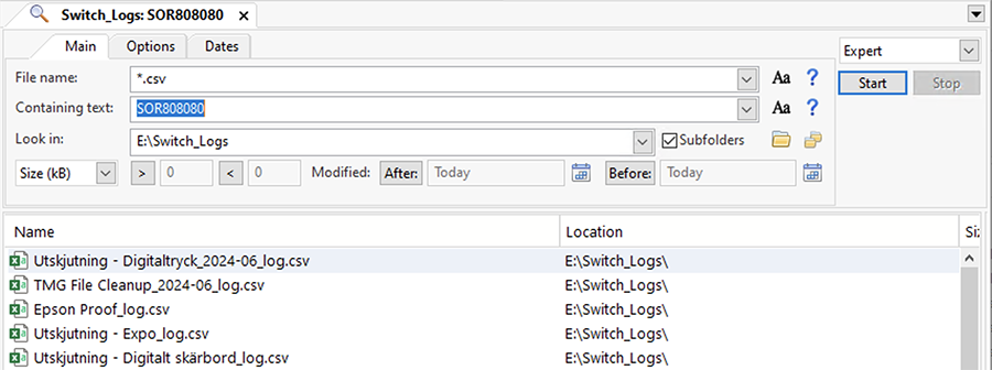

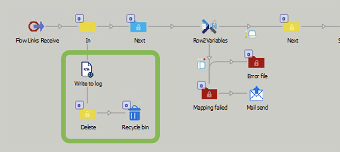

We only keep logs in Switch for 48h. But..
..we have added a generic log export as csv on all our flows using the app 'Create file from template'. We can search the csv logs with FileLocator Pro to quickly find what we are looking for like.
Have job X been processed?
What flow have job X been going through?
Who submitted job X?
What parameters was choosen on job X?
Have job X been archived?
