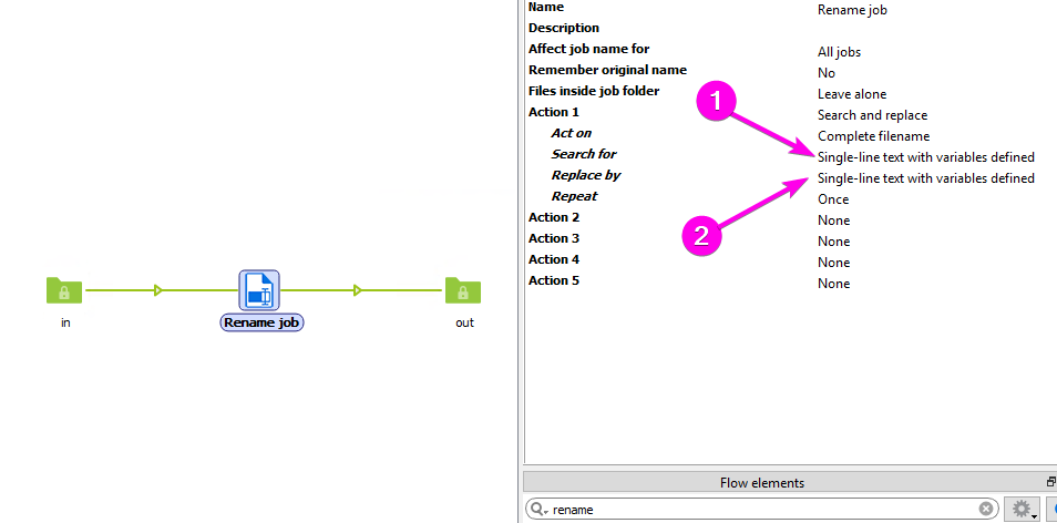

I am trying to remove an underscore "_" from the end of a filename using the Rename Job flow element and I'm not having any luck. It should be easy, but I'm stuck.

This will do:
1. _.[Job.Extension]
2. .[Job.Extension]

Yep, that worked. Thank You.

You should also make it recursive, to remove multiple underscore at the end, just in case :).
