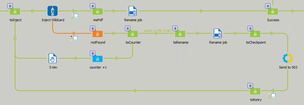

sander
Posts: 311
Location: Den Bosch
Re: Wait 10 minutes and search for the input name of the PDF in the output
Post by sander »
Wait For Asset is great. However, the last time I used it, I couldn't get it to inject (and thus search) a partial filename.
With Inject Wildcard, you can try to inject files based on a partial filename. So I came up with this:
In your case: with Inject Wildcard, just search for the original job name (before the .pdf extension) in your output folder. You can loop around to achieve your 10 minute wait.
Edit: boo, just read your reply. Too bad you are running 2022 :(

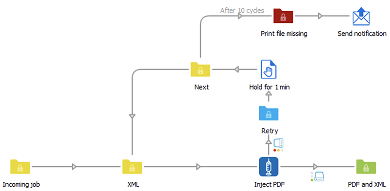

magnussandstrom
Posts: 571
Location: Sweden
Post by magnussandstrom »
I'm also using Inject Wildcard for cases like this. Here is a simple flow that edit to fit your purpose.
Link to flow: https://tinyurl.com/bd5mewph
