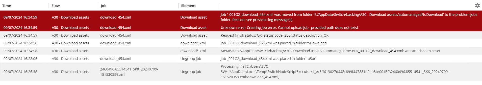

Hello!
So, I sent an e-mail for the support team already, but decided to post here either way in case someone is having the same problem.
Since the first 2024 update I've been having problems with Node's Socket Hangup error. It's said that the most recent update solves this issue, I still get it sometimes, but at least it's not multiple times a day like it was before.
Now my issue is the HTTP Request app, that under heavy loads is saying the "theUrl" parameter for some files has a problem and stops every other file process on that app. What's weird is that, if I stop then start the flow again, the same files that were stuck can go through as if nothing happened, even the file that "started" the problem.
Here's a link to a video of me stopping and strating the flow:
https://imgur.com/9p8vNPy

I am facing the same issue with the same error message. Both at 2023 Fall and 2024 Spring.
100% the same issue. It indeed only happens on heavy load.
Edit:
Do you also face this problem? 'Cannot upload job_ provided path does not exist' also happens now and then, under heavy load too. Stop/start flow and it will run without the same error again.
Also, talking about heavy load: the HTTP request will download 1500-2000 PDF's within a couple of minutes. What is your load?

sander wrote: Wed Jul 10, 2024 9:11 am Also, talking about heavy load: the HTTP request will download 1500-2000 PDF's within a couple of minutes. What is your load?
Sure, but the problem starts with only a couple hundred files being downloaded. The problem with this is that I manually need to stop and start the flow again, but I'm not always available to do that. When I'm not available the factory simply stops working thanks to those Switch errors.
My bosses want to scale the company, so thousands of files in a couple minutes will be a reality. My fear is that Switch won't be able to handle it and then we will have to look for alternatives.
sander wrote: Wed Jul 10, 2024 9:11 am Do you also face this problem? 'Cannot upload job_ provided path does not exist' also happens now and then, under heavy load too. Stop/start flow and it will run without the same error again.
I noticed that in the 2024 updates Switch stopped waiting for the files to be transferred between one folder to another.
I had to slow down hotfolders I had created for Switch, otherwise it would grab the folder the operators were still copying to the hotfolder and then this path problem would happen.
Tried to change hotfolder for SubmitPoints, but then browsers won't accept transfering folders with a couple gigabytes within them, for some reason.
The same happened to every HTTP Request I have. Had to add hold jobs with 4 secs between each job, so these erros would happen less often.
Now everything works a lot slower, since it has to wait for the downloads to happen.
