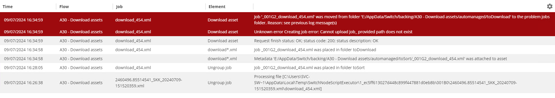

Do you also face this problem? 'Cannot upload job_ provided path does not exist' also happens now and then, under heavy load too. Stop/start flow and it will run without the same error again.

sander wrote: Wed Jul 10, 2024 9:11 am Do you also face this problem? 'Cannot upload job_ provided path does not exist' also happens now and then, under heavy load too. Stop/start flow and it will run without the same error again.
I noticed that in the 2024 updates Switch stopped waiting for the files to be transferred between one folder to another.
I had to slow down hotfolders I had created for Switch, otherwise it would grab the folder the operators were still copying to the hotfolder and then this path problem would happen.
Tried to change hotfolder for SubmitPoints, but then browsers won't accept transfering folders with a couple gigabytes within them, for some reason.
The same happened to every HTTP Request I have. Had to add hold jobs with 4 secs between each job, so these erros would happen less often.
Now everything works a lot slower, since it has to wait for the downloads to happen.
