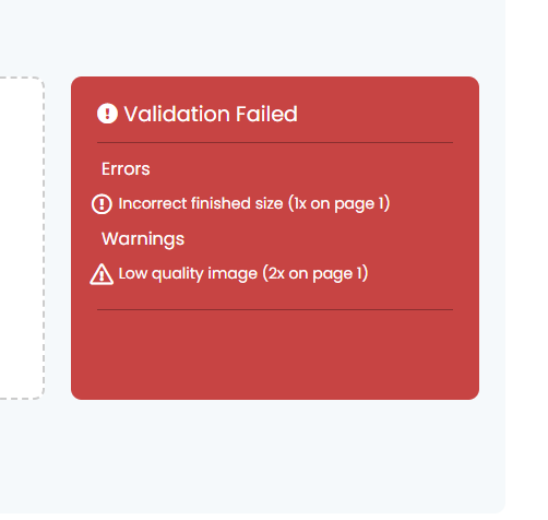

Post by DJS »
Hello, is it possible to remove the additional information not included in the custom message, ie "(1x on page 1)"
bens
Posts: 292
Re: Pitstop Pro error messages
Post by bens »
Not directly I think. You could probably achieve this by using some JavaScript code (if using JSON reports) or an XPath expression (if using XML reports).

You could also use string-replace app, working on the dataset (XML, or JSON) looking to replace following regex by whitespace
\s\(\d+x on page \d+\)=

May I suggest a more agnostic formula?
\s?\([^\)]+\)$
Hence, selecting everything between 2 parenthesis, except closing parenthesis, then closing parenthesis, at the end of the string?
There you would also extend to localised reports (to the exception of chinese/japanese probably)
