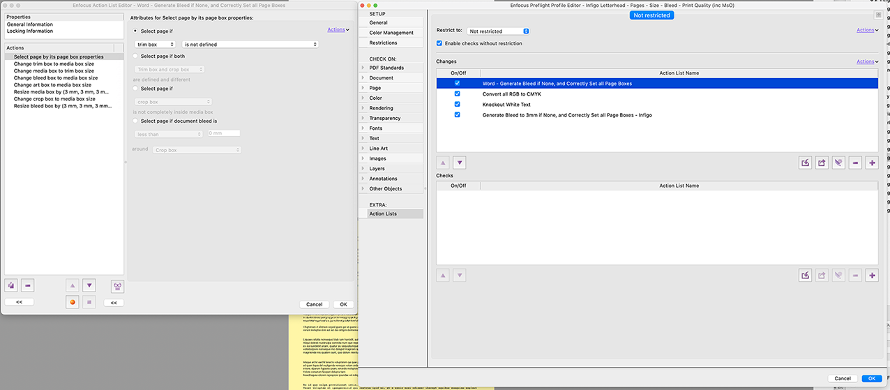

Our problem is flightchecking anything created out of MS Office needs to have the trim/art/bleed boxes set as they are commonly not present. Not a problem with the solutions I have been given by our Community. but the solution will also amend the boxes and add bleed etc to "proper" PDFs output from the Adobe suite, something not needed as they would already have everything set correctly, and could cause issues
Using the "Producer", was the only way we could think of that would differentiate anything from MS Office, but that doesn't catch everything, especially if created on a Mac... but happy to be enlightened!
Our biggest struggle is that we are using the PPPs made from Pitstop Pro, on the Infigo platform and don't have access to anything server side

It always relates to the fundamentals of PitStop, i.e. Selections.
Your problem is, like I suspected page boxes that in some cases are defined, in other are not. So, what you want is to get all pages without proper page boxes and fix them. That is done with a selection:
If all pages have proper TrimBox, you get nothing selected. And every Action that follows produces no effect.
If you follow that lead, you would see that it's very unlikely that you really need to do things for a specific producer. But once again, happy to be proven wrong.

by DJS
Quick follow up... have used that action as part of the PPP and all works as I had originally hoped for, thank you very much for all the help and advice
