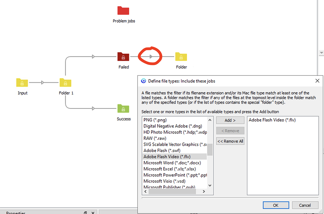

The easiest way to move a job to the problem job folder is to end the flow with an output rule that will never occur.
Example:
