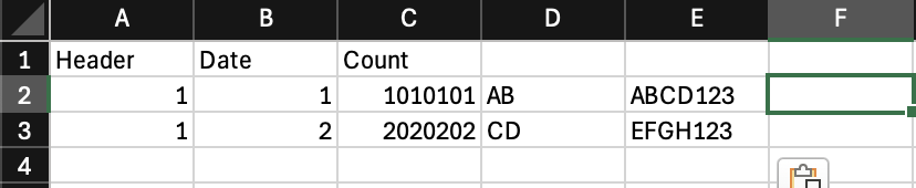

Thank you for replying, so I would like extract specific rows. first row to create some form of header and anything following (row two could like to extract column A, B, J, C, and finally D into a new file.
I guess which app would work best of something similar to this
This is how it's provided
Screenshot 2024-12-23 at 12.30.17 PM.png (66.05 KiB) Viewed 11166 times
how i would like to extract
Screenshot 2024-12-23 at 12.32.52 PM.png (27.26 KiB) Viewed 11166 times

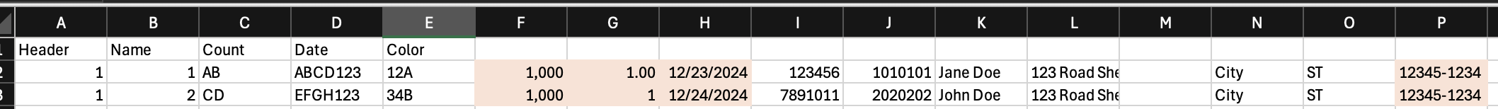

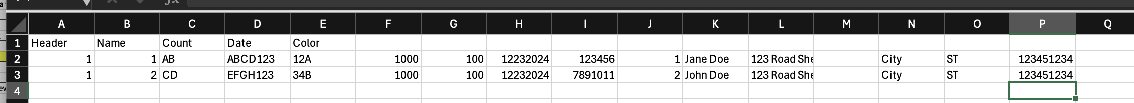

Apart from extraction request, I would like to make an additional file separate file, using what the client provided, where the highlighted is formatted. Is there a separate app that can do this as well?
Screenshot 2024-12-23 at 12.44.03 PM.png (56.36 KiB) Viewed 11166 times
one column is comma, one is moving decimal by 2 places, date, and zipcode +4
Hopefully this can help
