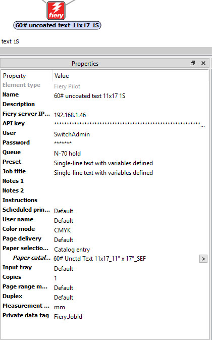

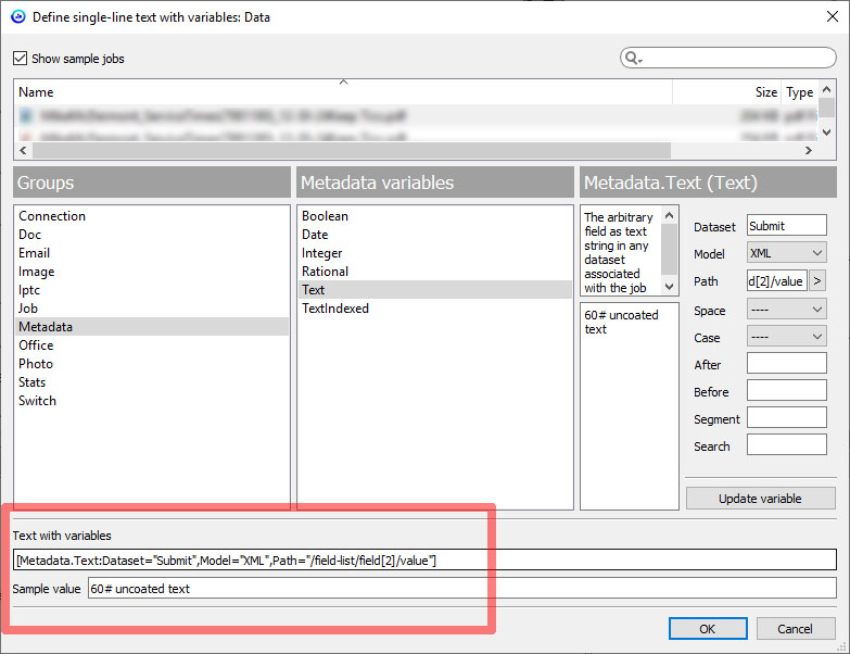

I just started using Fiery Pilot to move my jobs into Fiery Command Workstation after jobs have been processed in switch. I have a few different printers that I can send the jobs to, and each printer has a slightly different name in the Paper Catalog for a particular paper type. So when a user in my company enters a job into a submit points, they will select "60# uncoated text" for example, and that is saved here:
/field-list/field[2]/value
If I want to send the job to one printer, I have to assign it paper type '60# Unctd Text 11x17_11" x 17"_SEF'. If I send it to a different printer the paper catalog name is '60# uncoated text 11x17_Tabloid_SEF'.

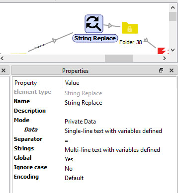

My question is: what is the easiest way to change the /field-list/field[2]/value so that it has the correct paper catalog name depending on which printer it's going to? Would using the String Replace app do this, and if so, what would I type in the properties? Or is there a better method for changing the value in an xml file?

In the Fiery paper catalog you can give each media a Product ID. This is just a number that you type in. If you give the same type of media the same Product ID on each of you printers you can use that instead of the long name defining the paper type.
In the Fiery Pilot app you then choose "Product ID" rather than "Catalog entry" to define the paper type.
The user who choose the paper type in the Submit point probably won't know the Product ID, so he will still choose "60# uncoated text", but now you only need to use String Replace to do this and it will work for all the printers:
60# uncoated text=6901
...6901, being the product ID of that media on all printers.
You will of course have to do similar for all the paper types but you can just write them on different lines in String replace. Like this.
60# coated text=6902
90# uncoated text=6903

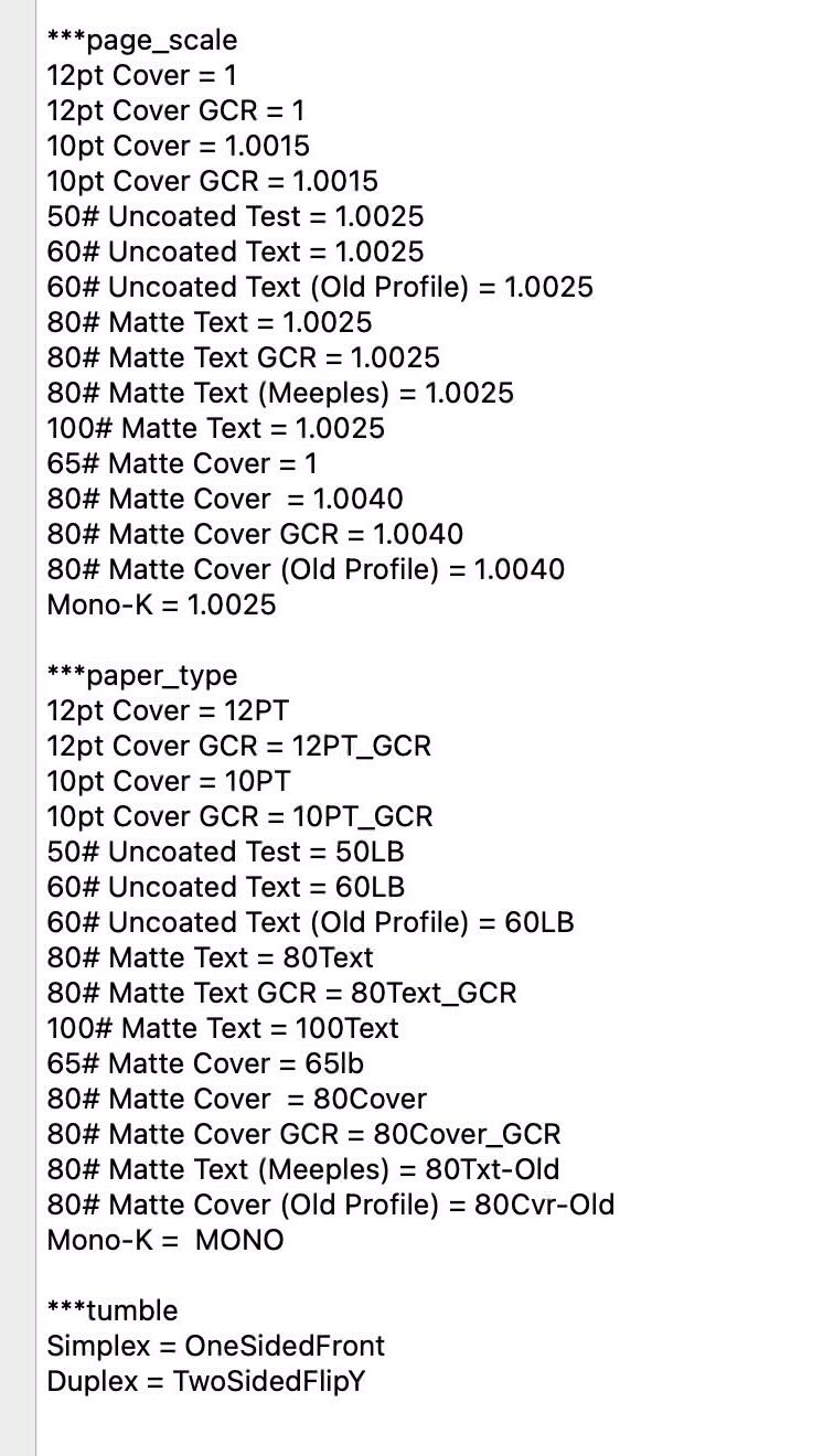

I feel like Private Data Magician is your solution unless I"m missing something. But as other suggest, it's a great app!
We do this for lot of things:
Use Paper Stock to change to the proper Print Profile & Press Profile
Use Paper Stock to give short name of the stock
Image scaling on press based on the ink coverage and paper type
and on and on...
Here are few.
and on and on...
Here are few.
