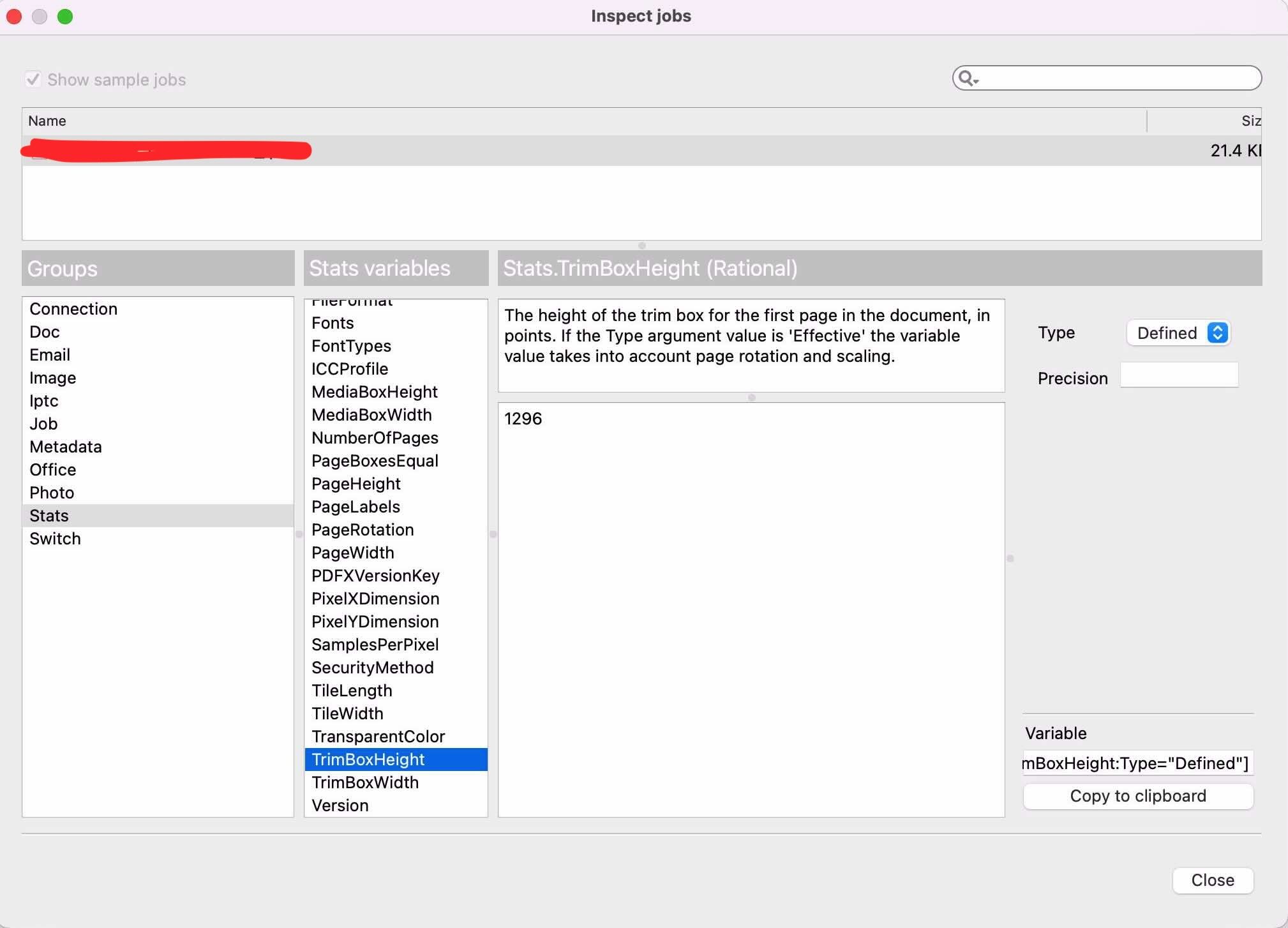

Yes, when you go into the 'Define text with variables' - > Stats -> there are all types of default stats about the file such as Trim Height/Width. It uses Points as the unit of measure so you'll need to do a switch calculation to get it to metric/imperial

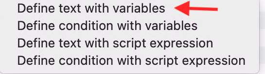

I can't do French but I can translate.. Hope this helps! I would suggest watching a few videos on Switch also.
Screenshot 2025-01-06 at 12.39.51 PM.png (69.89 KiB) Viewed 46362 times
Screenshot 2025-01-06 at 12.39.24 PM copy 2.jpeg (180.19 KiB) Viewed 46362 times

I don't think this is currently available in PitStop Pro. There are some actions (in the Action List editor) that have a list of page boxes, so if you're lucky the action you need has that. If not, you'll either have to use something external to PitStop Pro to get the values, or you may even be out of luck completely.
