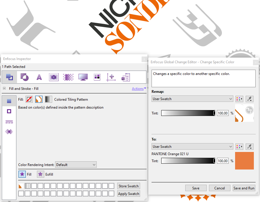

my PDF contains objects filled with a "Colored Tiling Pattern". Now the 4c orange is to be converted to a PANTONE color tone and the dark 4c tone is to be set to 90% black.
Which PitStop action can I use to select the vector elements in the colored tiling pattern to apply the color values so that I can recolor or map them to another color?
The Enfocus Inspector says about the fill color: “Based on color(s) defined inside the pattern description”. Is there any way to obtain this pattern description?

Indeed, we don't do color changes in patterns for some reasons. Can we get this discussion offline?
I would love to dig that topic further: you can contact me at loica => Enfocus () com
