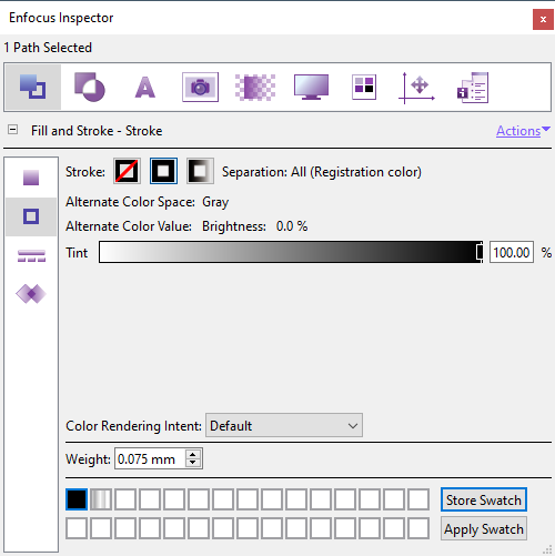

Re: Handling "All" Spot Color in a RIP That Misinterprets It as CMYK
Maybe it helps to define the Alternate Color Space of the spot/registration color 'All' in gray?
- All_gray.png (18.72 KiB) Viewed 40319 times
