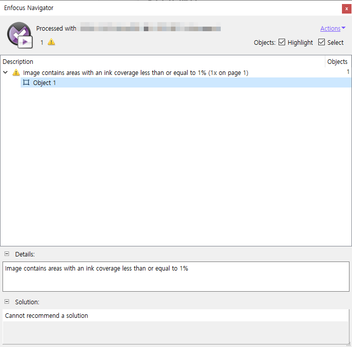

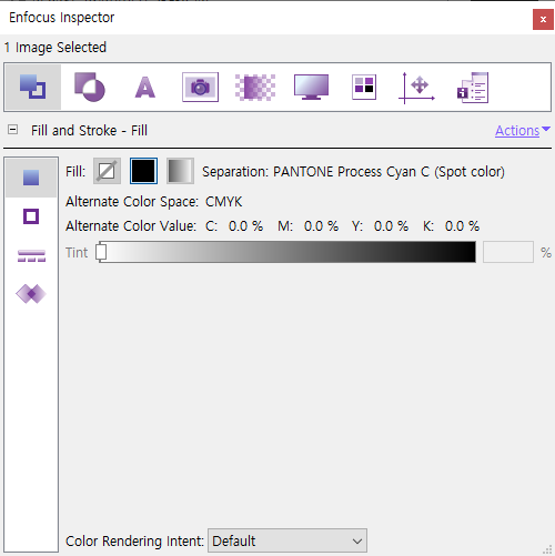

Is there a action list or preflight to Check if any Spot Colour has CMYk values of C 0 M 0 Y 0 K 0 as screen shot attached
