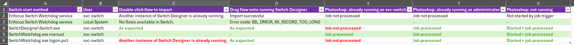

Once I had a likewise Photoshop issue too: it wouldn't start processing. After heavily testing I came to the conclusion there's different behaviour that depends on the way Switch is started. It might help you too:
OS: Windows Server 2019 + Adobe Photoshop 2024!
