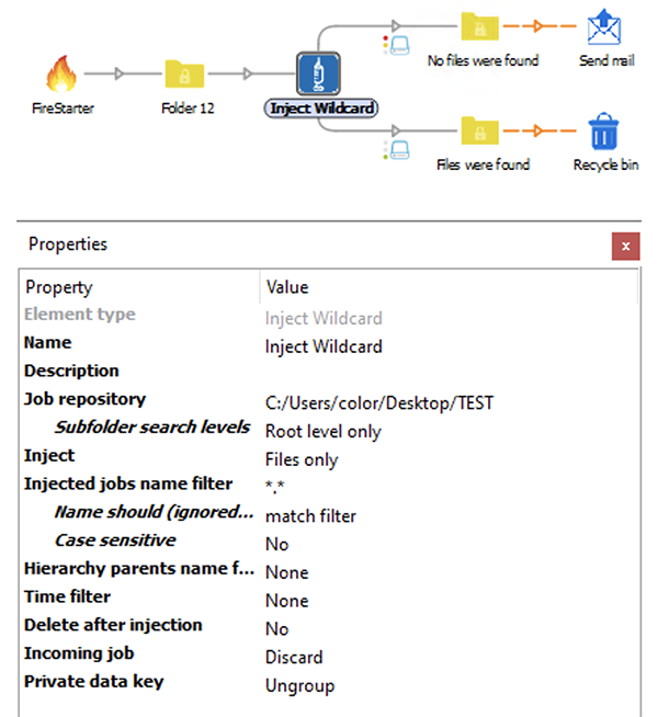

My idea for "send an email when the folder is empty":
1. FireStarter to repeat a dummy job (You can adjust how often you like to check the folder)
2. Inject Wildcard (Look for any file *.* in your folder. If found > discard and recycle dummy job, if not found > send mail)
Unfortunatly with this solution you will get an email everytime the dummy job is triggered until there are files in the folder again. But maybe someone else have a good solution for that.

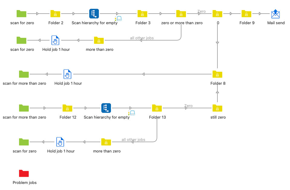

I made a flow that may be what you need.
First, a hot folder and you can input any file you like (just one file) once the flow is finished and ready.
Then Scan Hierarchy. You use this app to scan the folder in question. Your target folder is the Hierarchy top folder. Set to scan for file, all subfolder search levels. The name is variable * wildcard. Name should match the filter. This means any file found returns a match.
For Private Data Key, ScanForEmpty. You can name the dataset something similar but you don't really need it.
You can let the outgoing connection be both success out and warning out.
After the Scan For Hierarchy connection you have one folder, and then from that you need to branch off to 2 different folders. For one connection: [Switch.Calculation:Expression=[ScanForEmpty.itemsFound"]" is equal to 0. The other connection, all other jobs (make certain to set this, don't leave it on All Jobs).
For the all other jobs connection: let the file continue to a Hold Job (delay of 1 hour, or whatever you need). After that the file empties into the original hot folder. So it goes through the whole process every hour. Keep in mind: better to have this end element as a second folder in the canvas, even though it points to the same starting hot folder location. This way the job can start over each time properly.
For the other connection, where it found zero items. Add a connected folder after that. Then this will branch off to two things. First, Mail send. Then it also empties into what will be a second hot folder, in the same flow (after a hold of 1 hour or so).
This second sub-flow is very much like the first. It scans the same target folder using Scan Hierarchy and does it every hour. Build this sub flow to look the same as the first. The only difference is: when it finds zero, it just repeats this second sub-flow, emptying into the second hot folder each time. If it finds more than zero, it reroutes and empties into the first hot folder of the flow, to restart that process. Just remember, make the end points as separate elements in the flow from the starting hot folders (even though they are the same folder in Finder or Explorer).
This flow should send out one email when your target folder has zero files. If at any point it goes above zero files, and then drops back to zero again, you will get another email. The only hang up is: if your target folder has a bunch of empty folders in it, you would get the email then. I am not sure if you would have that situation. I tested with an invisible file in my target folder and scan Hierarchy overlooked it (I hope you have the same result, invisible files can be common in Mac and Windows). I have attached a screen shot of example flow.
Scan For Zero.png (54.49 KiB) Viewed 64382 times
