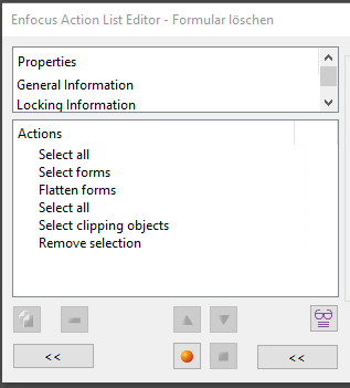

for your PDF you could try the action list as shown in the screenshot.
Regards
Yosimo
remove unvisible objects.png (7.56 KiB) Viewed 25761 times

sorry, its doesn't working

Yosimo's script looks to do the job to me.
Do you have "User Selection" set in the "Run on" menu and no selection active?
