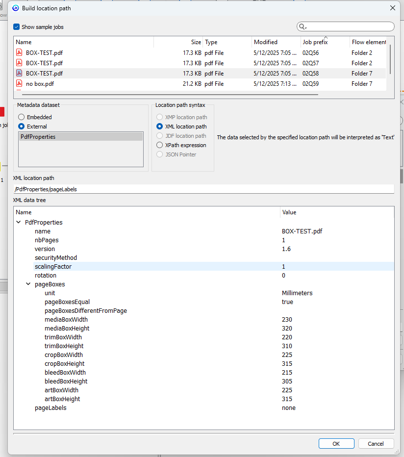

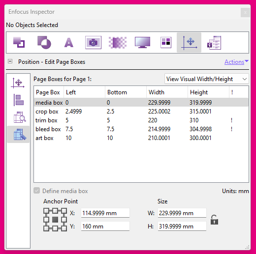

Hello!
I was trying to use this script to get box values ​​in mm and noticed that cropbox and artbox have the same values.
But not in PDF! Here is an example of a PDF file in Pitstop Pro
and also the values ​​in Switch using the PdfProperties example script.
What could I be doing wrong?
Thanks in advance

I've just had a debug through the PdfProperties script with a blank PDF I made matching the values of the screenshot and I get the same result as you with the artBox and cropBox values being the same.
I don't think this is something you or the script is doing wrong. When I was debugging it looks like the calls getCropBoxWidth and getArtBoxWidth / getCropBoxHeight and getArtBoxHeight return the same values 637.7956999999999 and 892.9134.
Unless I'm missing something obviously wrong with the PDF I made (Blank PDF made with Enfocus Create Document through PitStop Pro) it looks like an issue with how the Switch Scripting Engine is parsing this PDF

Thanks for reporting this. It does indeed seem like it is a bug in the PdfPage class. I logged it.
Art boxes are not used very often, so I hope you do not suffer from this. If it is important to you and you have PitStop Server then I suggest to use the FastLane app: https://www0.enfocus.com/en/appstore/product/fastlane
