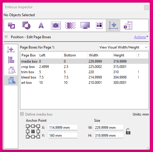

I was trying to use this script to get box values ​​in mm and noticed that cropbox and artbox have the same values.
But not in PDF! Here is an example of a PDF file in Pitstop Pro
and also the values ​​in Switch using the PdfProperties example script.
What could I be doing wrong?
Thanks in advance

I've just had a debug through the PdfProperties script with a blank PDF I made matching the values of the screenshot and I get the same result as you with the artBox and cropBox values being the same.
I don't think this is something you or the script is doing wrong. When I was debugging it looks like the calls getCropBoxWidth and getArtBoxWidth / getCropBoxHeight and getArtBoxHeight return the same values 637.7956999999999 and 892.9134.
Unless I'm missing something obviously wrong with the PDF I made (Blank PDF made with Enfocus Create Document through PitStop Pro) it looks like an issue with how the Switch Scripting Engine is parsing this PDF
