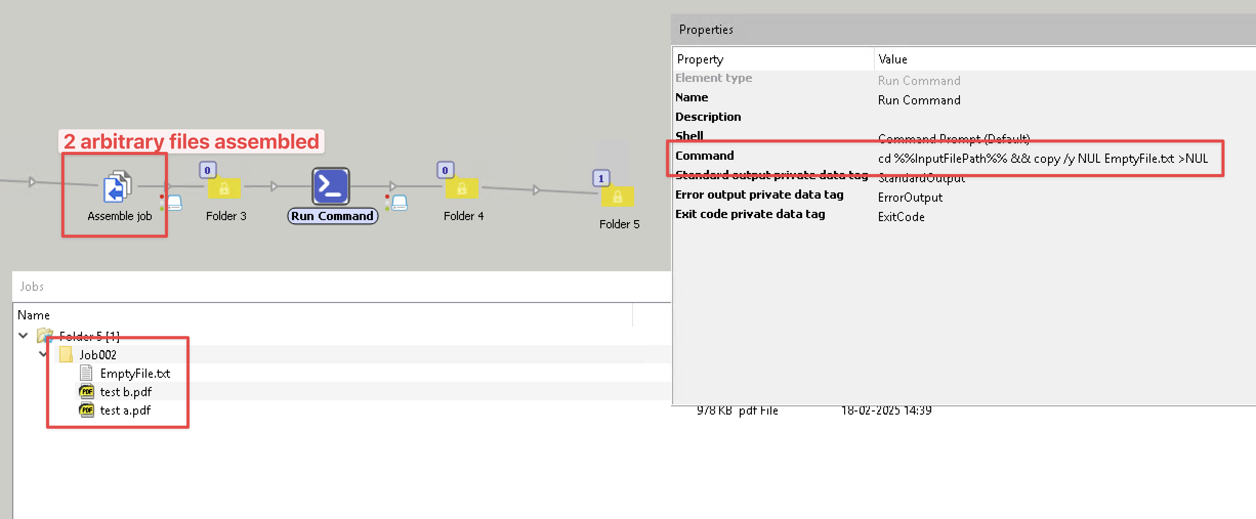

It could then look like the flow below.
2 arbitrary files are assembled into a jobfolder.
The "Run Command" app cds into the directory and runs a command to create an empty file.
This is created in the job-folder.

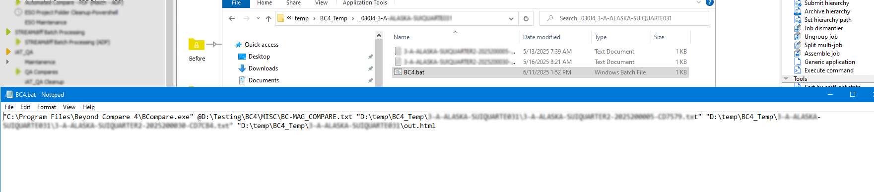

This is my flow. I am creating a .bat for each job using the "Create file from template" app and private data and placing that .bat in the job folder
Below is the .bat file that is needed to run
What i am trying to do is use Beyond Compare to compare approx. 400 text files. I can only run one at a time, but they run in 1 or 2 seconds. The flow is using the job name as the job folder name, so maybe what i can do is keep the job folder name the same, then i can use your idea to CD into it and run the .bat file, which will always be the same name.

I got it working.
Ended up using the app "Create File From Template" and built my batch file with it.
First I make a copy of the job folder, then run the batch file, it send output to the BC4_temp folder. The "Run Command" sends the job folder on to "Folder 12", why I do not know, but this works for me.
Thank you for your help!
