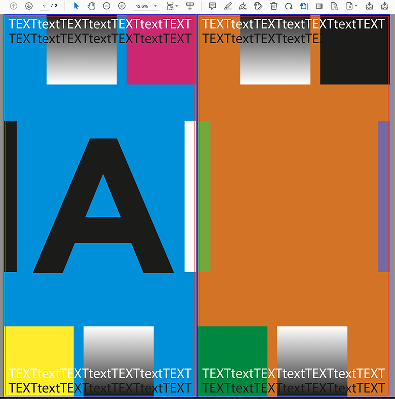

Below is the original input pdf.
Original 2 page
Original 2 page

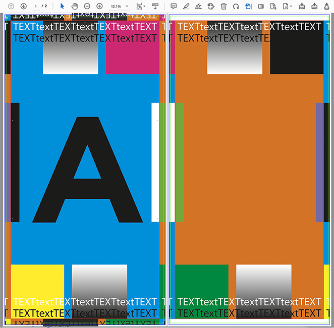

After the actions - Attachment below shows both pages (Pages 1&2 - Left & Right correct. Page 1 - Top & Bottom correct. Page 2 Top & Bottom wrong)
Using Actions with Page 1 correct and Page 2 wrong

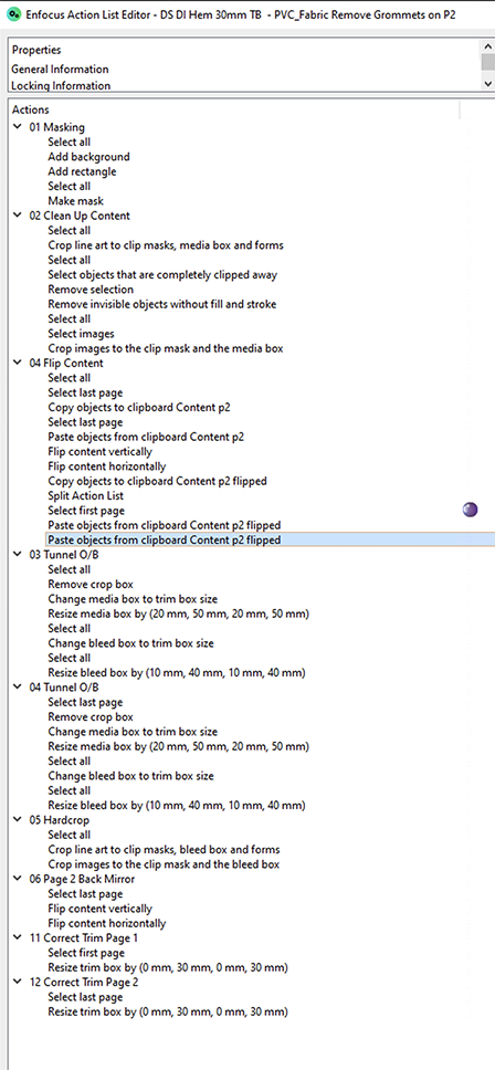

Action List so far - Just need to work out a way to get the page 1 copied on to page 2, rotated and moved top and bottom just like what I have achieved for page 1.

I have tried so many combinations but all fail to action the page 2 as I need.
