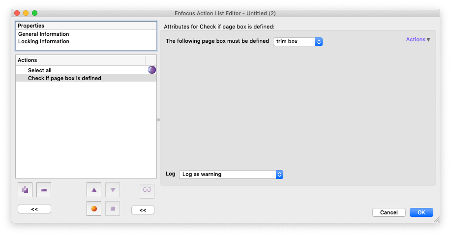

Is there a Trim Box.
Screen Shot 2019-09-10 at 2.48.40 PM.png (72.73 KiB) Viewed 11221 times
Action List attached.
Check if Trim Box exists.zip
(1.75 KiB) Downloaded 2256 times

Then for the Trimbox vs Media Box you need 'Check if Page Box is too large' and/or 'Check for differences in Page Boxes"

bumped into some anoying issues, but i think i found a solution.
correct me if i'm wrong but 'Check for differences in Page Boxes' doesn't work because the value's you fill in have to match exactly, bigger then the value is also not okay?? don't understand why that is but.
anyway after some trial and error
because there is an option to compare the bleed box to the trim box, i checked the document for a missing bleedbox, if it is missing i'm adding (i hope this doesn't demand a lot of processing power) one that has the size of the media box and then do the check between the trim en media box. i included my solution.
I haven't tested it yet with a lot of files.
kind regards
Boris
TrimboxControle.zip
