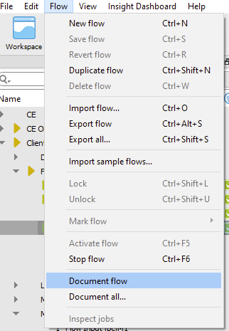

Hi
if you can document the flow and either save the html file or as a PDF and post that will help find the issue.
Screenshot 2020-05-19 at 09.26.38.png (33.14 KiB) Viewed 5766 times
