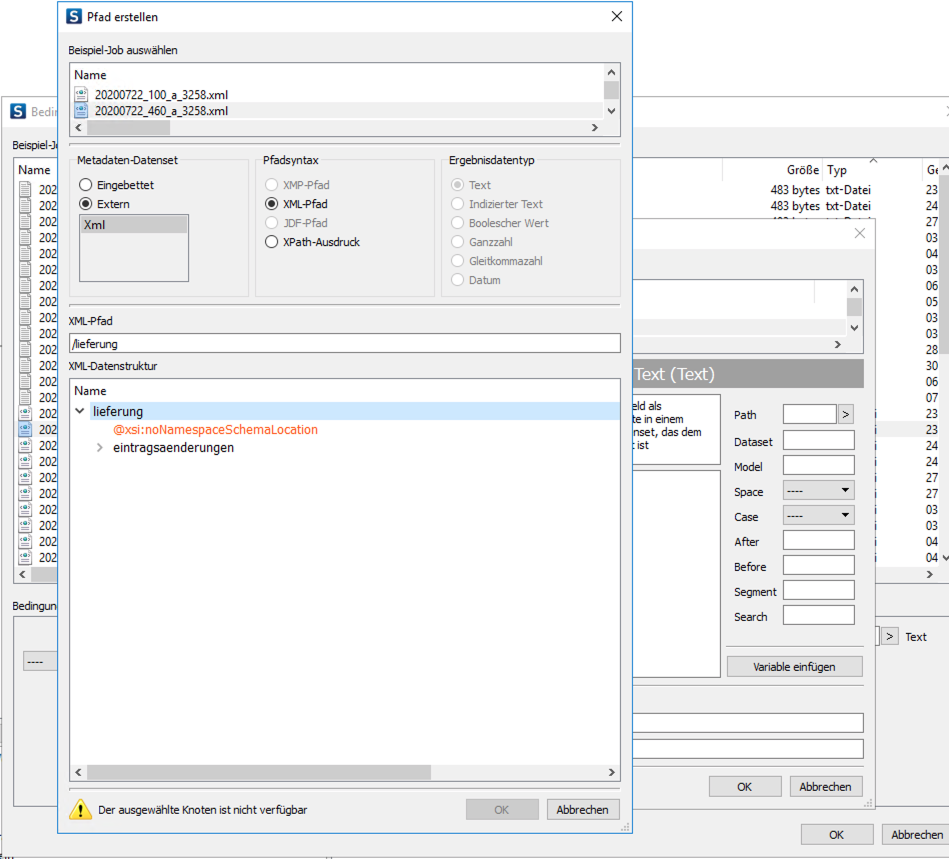

Hey there,
I use "job.getVariableAsString(' ')" to get a XML-Path as string in my script. But i only get undefined. Also when I try to select that node directly it says that this node is not available altough I can select it. See the pics
Bildschirmfoto 2020-08-21 um 10.09.04.png (34.14 KiB) Viewed 51721 times
Bildschirmfoto 2020-08-21 um 10.24.45.png[/attachment ][attachment=0]Bildschirmfoto 2020-08-21 um 10.06.11.png

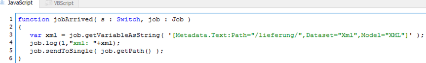

My script so far:
	var xml = job.getVariableAsString( '[Metadata.Text:Path="/lieferung/",Dataset="Xml",Model="XML"]' );
	job.log(1,"xml: "+xml);
	job.sendToSingle( job.getPath() );
How can I get the XML-Path "lieferung" as a string in my script?

gosh something is weird with the pics in this forum... :-/
Bildschirmfoto 2020-08-21 um 10.06.11.png (69.79 KiB) Viewed 51719 times
Bildschirmfoto 2020-08-21 um 10.24.45.png (218.24 KiB) Viewed 51718 times
Benjamin

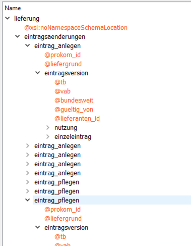

bkromer wrote: Fri Aug 21, 2020 10:30 am Bildschirmfoto 2020-08-21 um 10.24.45.png
Your screenshot shows that \Lieverung\ has an attribute and a subnode, but no simple string content. I guess that is why the variable doesn't return anything.
Which return do you want to get?

Padawan wrote: Fri Aug 21, 2020 11:36 am
You are right. When I go down to some sub-nodes and select a value it's working.
Well these xml files are heavily nested. "Lieferung" is the main node and I thought I could iterate over the sub elements in my script.
Bildschirmfoto 2020-08-21 um 11.41.25.png (67.94 KiB) Viewed 51709 times
