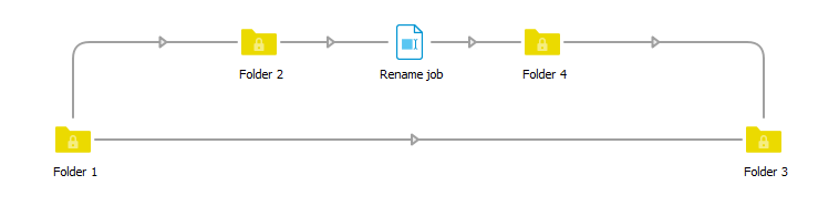

Can't you just do like this in Switch:
Jan Suhr

hover27
Posts: 14
Joined: Sat Apr 20, 2019 3:49 pm
Re: copy with Process.execute
Post by hover27 »
@jan_suhr
no, that is not what I need.
I need to copy two files together.
That is only possible with the internal command copy.
With the parameters of copy, I can copy two files into one file.
That's why I need to do it with Process.execute() and the copy command.
