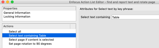

You can base your selection on a specific text (ex "Table", if all tables are rotated).
Then select the pages (if objects are selected) and rotate them.
select text.png (31.42 KiB) Viewed 7865 times

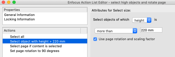

If this is not accurate enough, you can base your selection on the vertical lines in the tables.
select object.png (36.75 KiB) Viewed 7865 times

Probably best to have an 'AND' after the two selections before the rotation.
