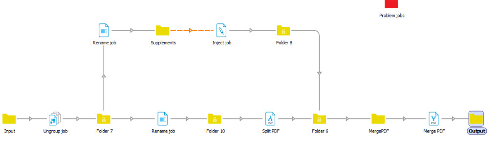

I am attempting to create a Switch flow that does the following -
  • Submit a group of files - i.e. file A, file B, file C etc
  • File A must be merged in each of the other files, after page one of the file
I have created the following flow which routes file A to a folder to inject into the other files. I can use Inject Job to insert file A into one other file, but when I have multiple files I need file A inserted to I have to rename the file for every instance so that it inserts in the correct order of the new merged file. Is there a better way to do this?
IImage
switch flow.jpg (31.01 KiB) Viewed 4099 times

You can use pdftk to do that. You run it with Execute command or the app Run Command.
https://www.pdflabs.com/docs/pdftk-man-page/
