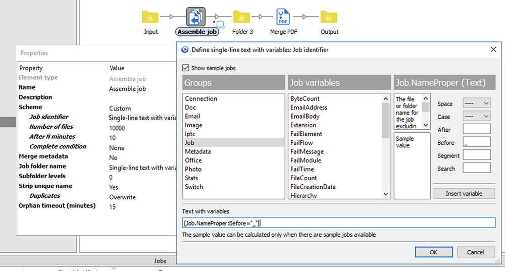

Would this work for you?
Since you don't know how many files you are getting I set a time limit in Assemble job to 10 minutes (you can change it as you like). The flow will group jobs with the same prefix (before the first underscore) and sort alphabetically when merging the PDF.
I suggest to set the Assembled job folder name to [Job.NameProper:Before="_"]_merged or similar.

Yes, this does the trick.
