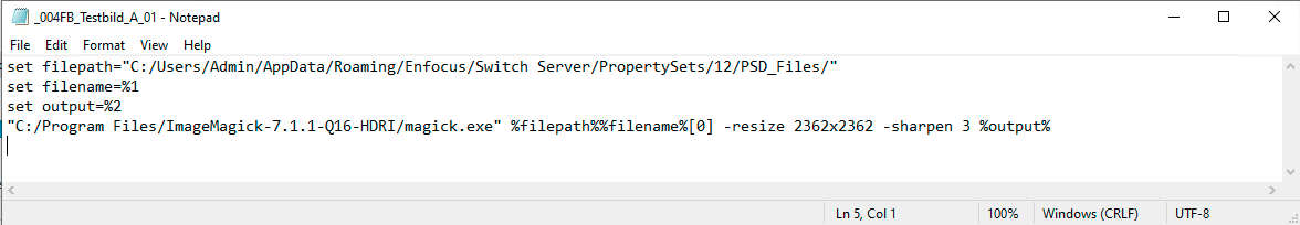

I create a unique bat file for every image, and it looks like this.

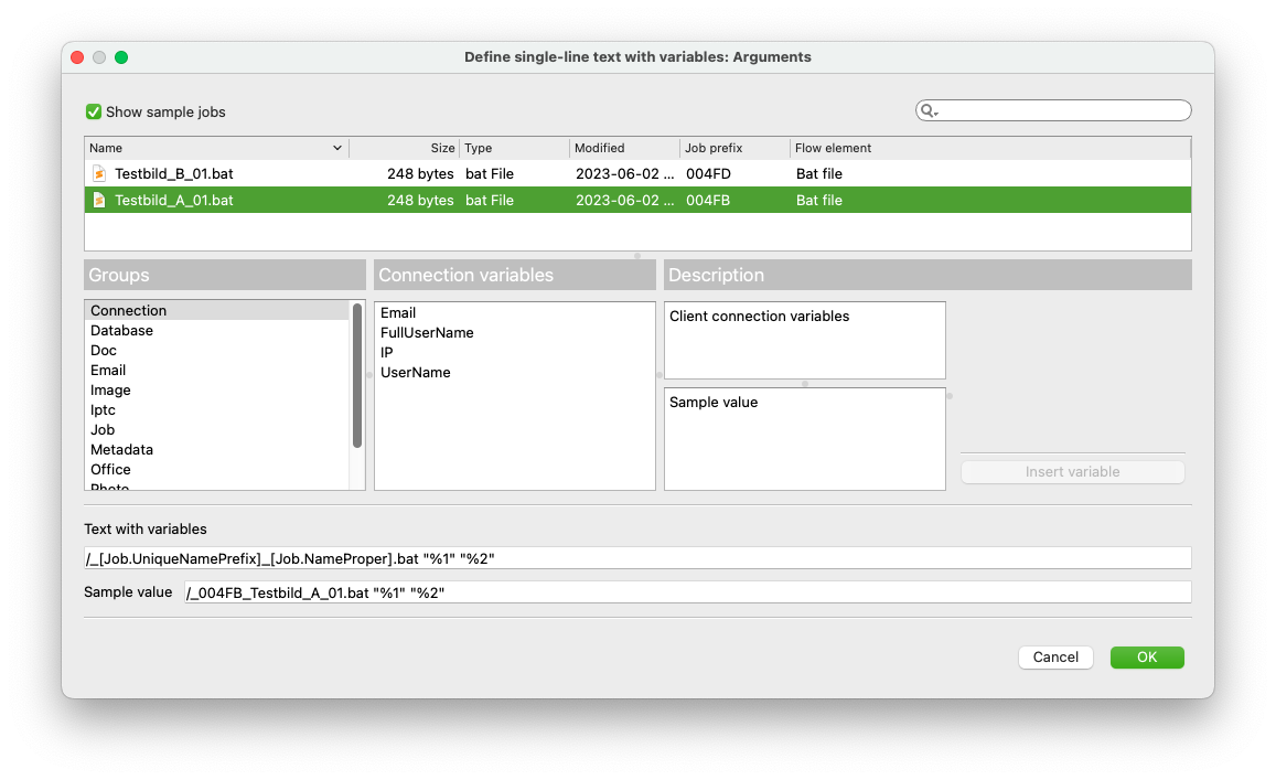

Then this is my Arguments
Skärmavbild 2023-06-02 kl. 13.31.27.png (152.88 KiB) Viewed 5972 times
But i do get a space between my static search path and the bat name, so i think this i why it doesn't work. Any suggestions on how to get rid of the space between the static path and the calculated name?
