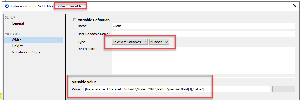

This is the way.
1+2. Select your Variable Set.
3. Go with Text with Variables.
4+5. Define your Switch variable over here.

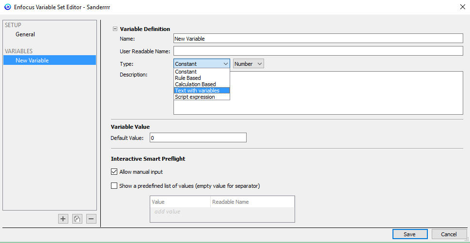

Thanks Sander, but I dont have 'Text with Variable' as an option?

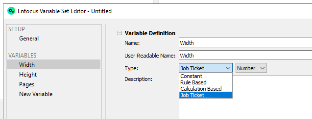

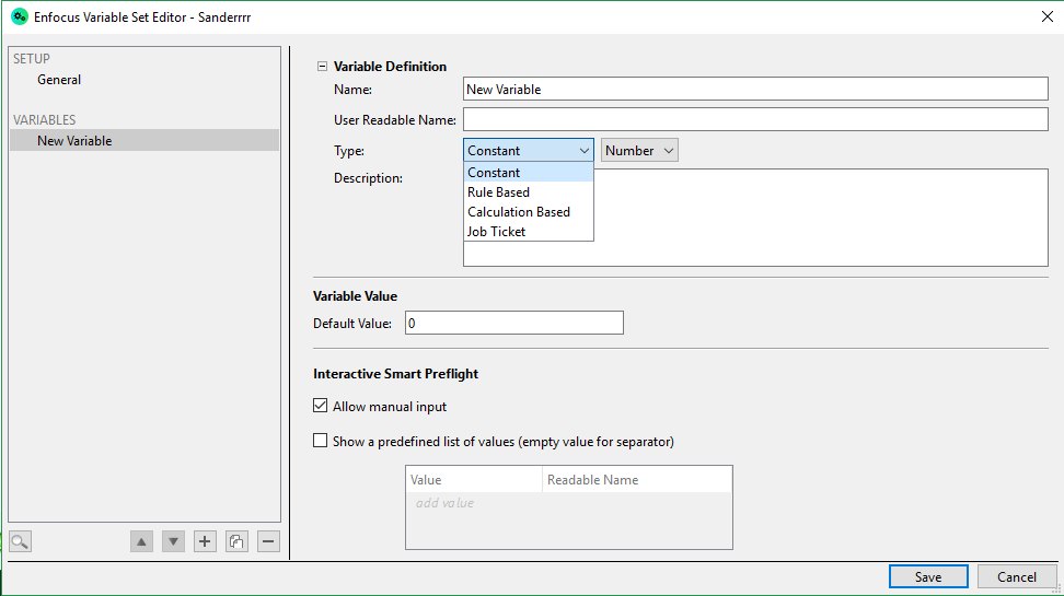

Do you open the variable set via Switch or directly via PitStop server?
PitStop server:
Via Switch:
Notice the difference? :)

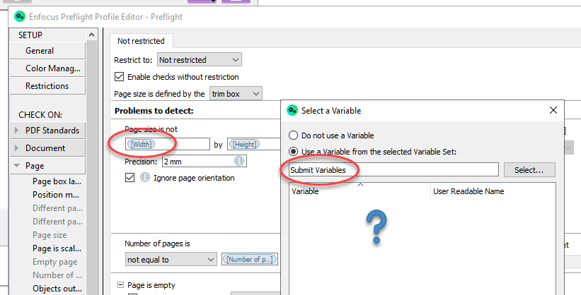

Thanks both I have now managed to get the variable set setup as below.
Variable Set
Variable Set
But I cant read these variable within a Preflight profile?
Preflight Profile
Preflight Profile

Hi
You need to set the variable type as "length". Number as you set is needed for abstract numbers like a number of pages, or separations.
When you come to check dimensions, you need length which introduces unit (mm, in…)
Hope that helps,
Loic

That worked thanks @Loic
