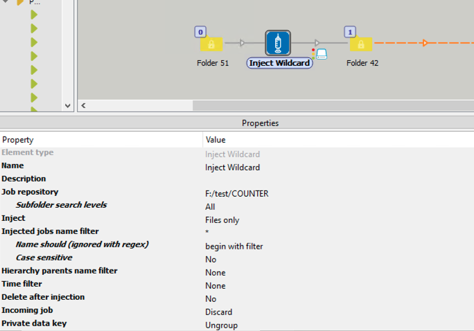

I would like to be able to create a dummy job using "inject job" without moving the original file from the incoming folder.
What I need is to count (with Counter Plus) how many files are put in the folder but I need to keep files in the folder: this is the working folder of GMG Colorproof.
The flow
The properties of "inject job"
How to create a dummy file without moving the original file from the incoming folder

Re: How to create a dummy file without moving the original file from the incoming folder
With the app Inject Wildcard you can choose to keep the original file at it's place. And maybe the app Scan hierarcy could be beneficial for your flow.
Are you sure about that?
Inject Wildcard doesn't seem to be the right app
"This is the perfect solution when you don’t know the complete name of the job(s) to be injected or want to inject more than one job."
I did some test though and can't find any properties to keep file in the original folder It keeps on moving the file from the original folder whatever option is set up
'Delete after injection' could be translated to 'Remove the file from original folder after injection'. If you set this to No the file traveling down your flow is only a copy and the original file is kept in place.
The Folder apps bundle could also be interesting for you depending on what you are trying to do.
Could you explain in more detail what you are trying to achive? It's easier to give advice if we get the whole picture so to speak.

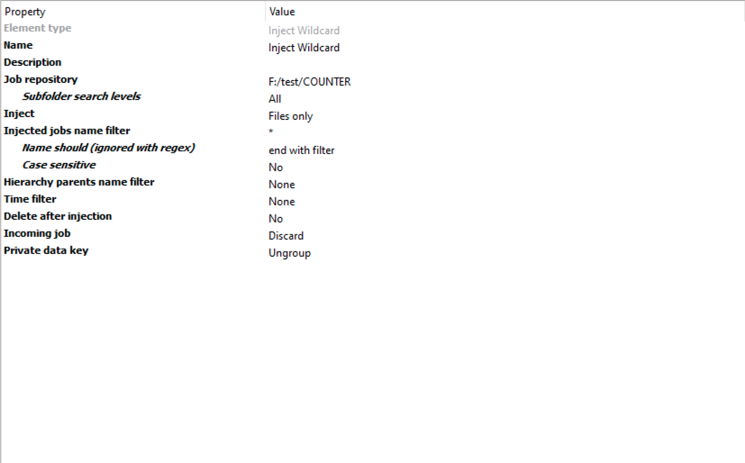

Delete after injection set to NO move the file from the original to the next folder as you can see on this screenshot
The usecase is:
We have folders originally used by Epson (with GMG Colorproof software) printers where people put files to print (obviously
We would like to count how many file are put in these folders without changing folders or flows from printers
