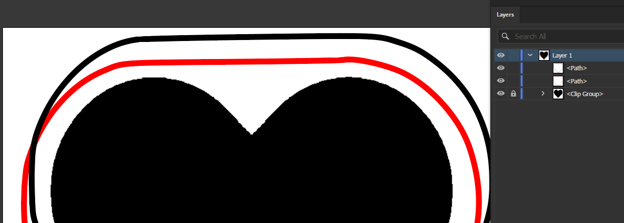

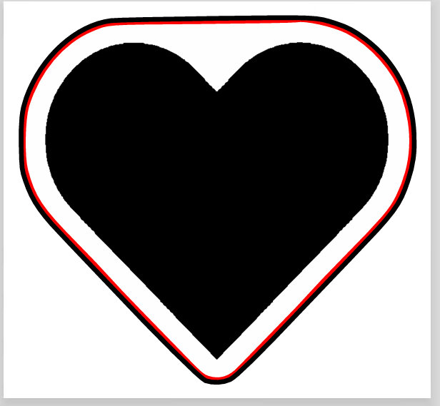

I was able to expand the boxes and make the line art Red. However, why when I select the line art (See action list) does that not just change the traced path instead of making a new one?
double paths.png (43.28 KiB) Viewed 37350 times
Action List.png (6.83 KiB) Viewed 37350 times
loicaigon
Posts: 782
Re: Add Trace Path question...
Post by loicaigon »
I don't see a reason why you get a doubled path. I reproduced the action as you did and I don't get that result.
Are you sure they were no paths before you run the action?
Feel free to share files here so that we can further investigate.

loicaigon wrote: Wed Jan 22, 2025 9:12 am I don't see a reason why you get a doubled path. I reproduced the action as you did and I don't get that result.
I have resolved the double path issue. It turns out it was a "IBM" error.
I had a Preflight Profile calling the action & the Action List selected in the Switch app.
So, all is good for now!
Thanks again for your help @loicaigon!
