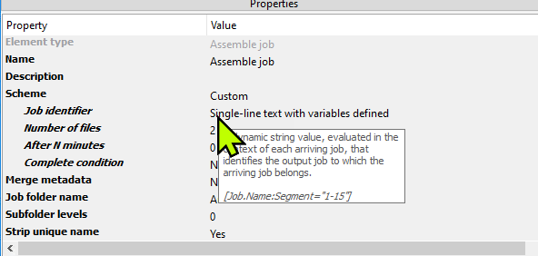

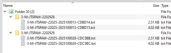

Thanks but I think I maybe explained my problem wrong. I am looking to assemble a job from 2 different incoming folders, Folder 1 and Folder 2.
I assemble the job folder with 2 files, one from each incoming folder, based on a segment of the name, 1-23 positions.
This works fine except for most files. However, I have 2 files in each incoming folder that are almost exactly the same name:
Folder 1 - 3-M-JTSPAW-22025-2025100013-CDBD14.txt and 3-M-JTSPAW-22025-2025100013-CDBD15.txt
Folder 2 - 3-M-JTSPAW-22025-2025100028-CDC5BB.txt and 3-M-JTSPAW-22025-2025100028-CDC5BC.txt
NOTE: the first 11 characters are always the same, 3-M-JTSPAW-
The assemble app is assembling both files from Folder 1 together and both files from Folder 2 together.
How can I get it where it puts one file from Folder 1 and one file from Folder 2 together?
I understand the original filenames are close but I cannot do anything about it. I have rename job app remembering the original name.
Assemble job settings
This is what i am getting with my assemble job
Thanks for your suggestions!

There is a contradiction in the description: you mention positions 1-23, but in the screenshot the value is 1-15.

I need to run a few hundred files. The desired output i am expecting is a job folder with two files, one from Folder 1 and 1 from Folder 2.
This flow will comparing a before file, ie Folder 1, and an after file, ie Folder 2. The files in either folder are similar so i am using the first 23 characters of the filename to assemble a job folder with 2 files.
This method of assembling a job works for my hundreds of file pairs except the 4 files i have mentioned.
The problem i am having with these files is assemble job is taking both files from Folder 1 and outputting them to a job folder, and doing the same thing to the files in Folder 2.
I need assemble job to take one file from Folder 1 and one file from Folder 2 and output them to a job folder
The job folders, after assemble, i am expecting is:
3-M-JTSPAW-22025-2025100013-CDBD14.txt (Folder 1) and 3-M-JTSPAW-22025-2025100028-CDC5BB.txt (Folder 2) -> Job folder 1
and
3-M-JTSPAW-22025-2025100013-CDBD15.txt (Folder 1) and 3-M-JTSPAW-22025-2025100028-CDC5BC.txt (Folder 2) -> Job folder 2
I hope this clears up things. If not then i am sorry for wasting your time.
Thank you
Posts: 1189
Re: Rename file based on contents
It is clear that the first 23 characters are not a 100% solid way of combining the files because all 4 have the same first 23 characters. The obvious question: is there some other property that is common to the files that do belong together? If there was, you could concatenate both properties (the first 23 characters and that something else) in the "Job identifier" property and the problem would be solved.
Based on the filenames the only strategy I can think of is the following: if there is more than 1 file in one input folder with the same first 23 characters, there must also be the same number of files in the other input folder with the same first 23 characters, in which case they must be assembled in alphabetical order.
Correct? That is scriptable, but I would first investigate if there isn't some other piece of information, possibly from the PDF itself, that can be used to make the desired combination.
