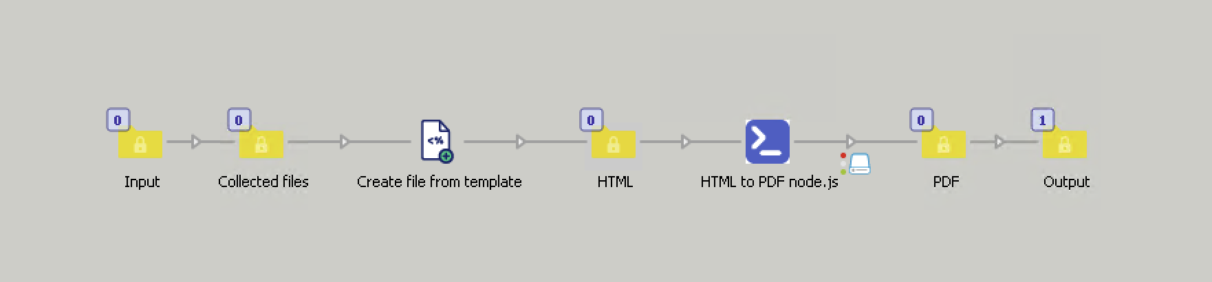

I do not have the database module, but have in other case used a JSON-file of an order.
Then used the app "Create file from template" https://www0.enfocus.com/en/appstore/pr ... m-template to generate a HTML.
This HTML is then converted to pdf to get an order sheet.
So if you are able to extract the data from the database to a JSON-file you can use this approach.

Flow
Royal TSX-Flow-server03-2025-08-04 at 14.35.50@2x.png (45.01 KiB) Viewed 4875 times
