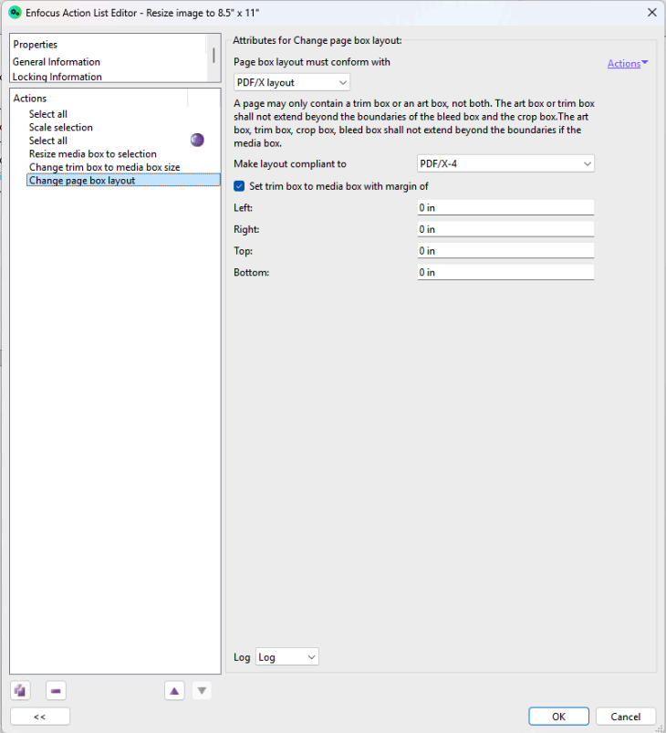

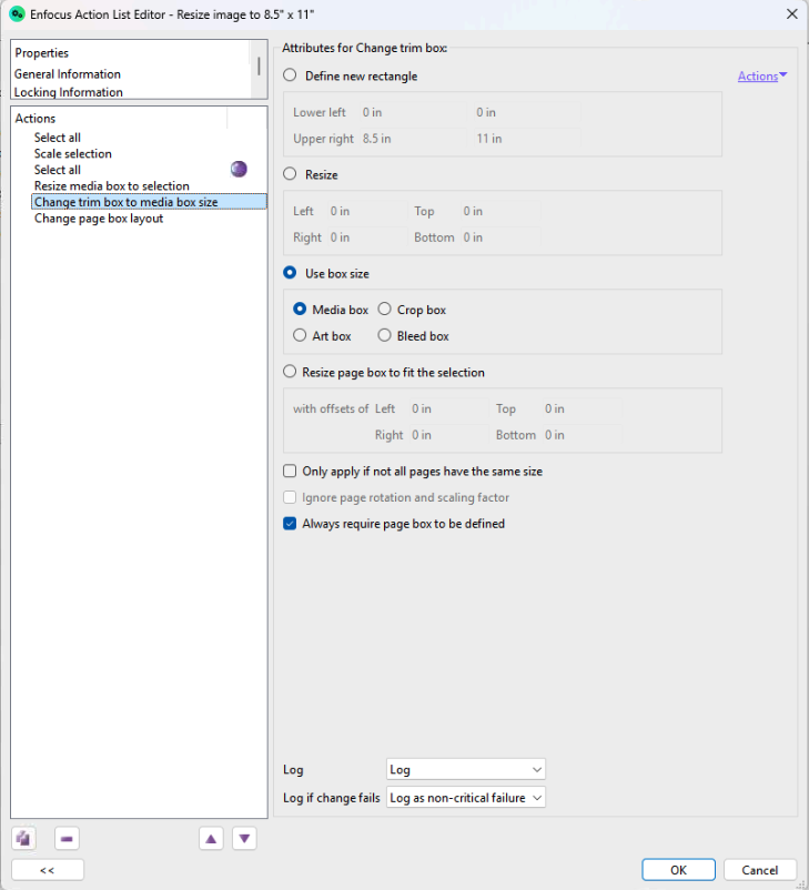

I've attached some screenshots of my action if anyone can see where I'm going wrong...?

I can't see something immediatly wrong. You might have an extra uselss "Select all" as the very first one should still apply at step 3.
And I presume the last one is redundant with what you have before (except the PDF/X setting might indeed add bleed box).

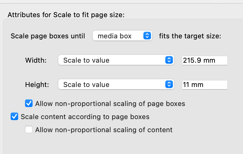

Would also be curious about your settings in the Scale selection.
Apart from that, if you want to scale content to be 8.5x11 and then adjust page boxes size, what about "Scale to fit page size" as in: You Action List may then be
- Select all
- Scale to fit page size [mediabox => 8.5x11]
- Change page layout or Change trim > mediabox and Change bleed to mediabox to remove bleed box.
Not sure it would solve your issue though but may simplify.

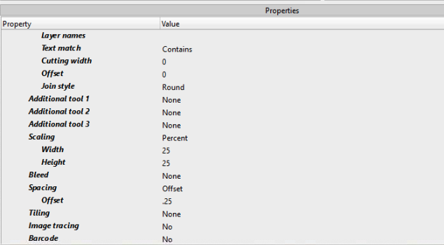

I've also attached my Griffin settings here in case that helps.
thanks!
EDIT: I don't know why but I thought the scaling setting was visible in my last Screenshot. This new one should actually show it.
