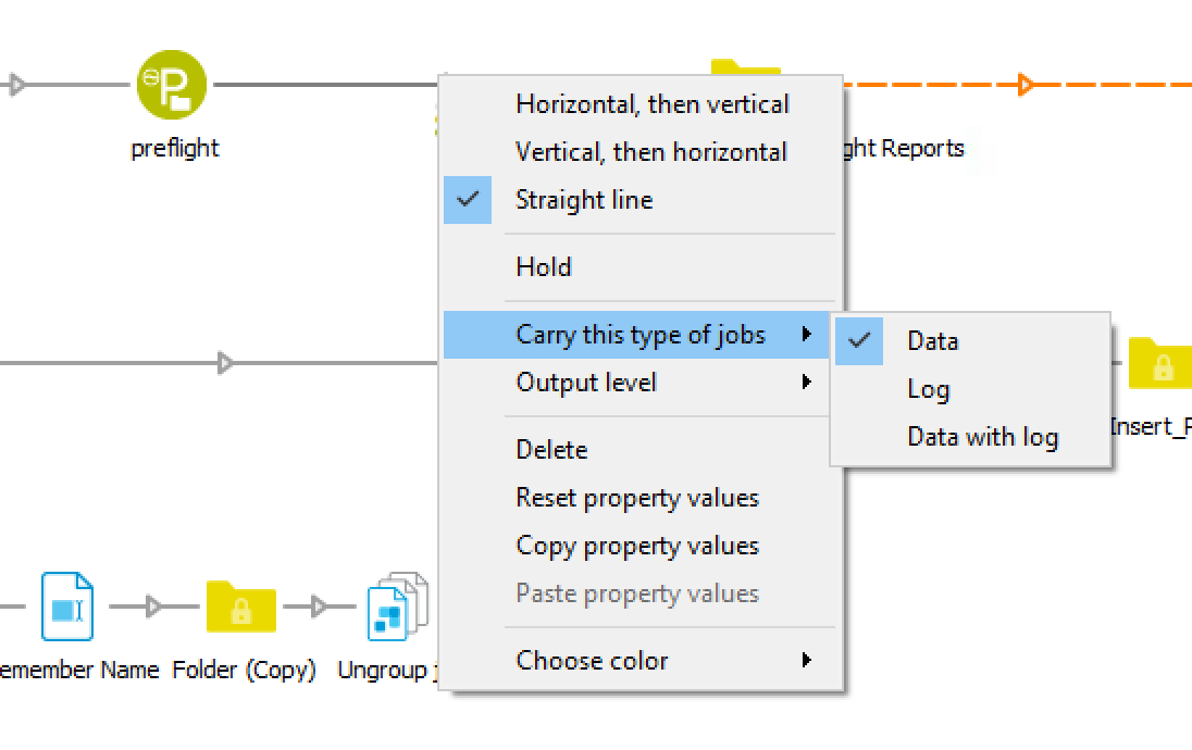

Hi Im trying to do the same (well similar) but am fairly new to switch.
to start with i just want the report in a folder but i just get the original pdf
when you say:
You need to have a data and a report "line" from pitstop server. Then you get the report as a pdf.
are you referring to the 'carry this type of jobs/data or log or data with log????
could someone attach a screen shot of what this flow looks like ??? 8-)
Screen Shot 2017-10-12 at 17.25.22.png (52.16 KiB) Viewed 15364 times
lombert
Posts: 167
Joined: Fri Feb 04, 2011 2:31 pm
Location: Sweden
Re: Email preflight report
Post by lombert »
Yes, That’s correct. The fixed/checked pdf is data, and the report is log. It can be txt, pdf you change that in the preflight.
The last is the pdf with meta-report..

whitey666
Posts: 6
Joined: Fri Jun 09, 2017 5:43 pm
Post by whitey666 »
Thanks lombert its working now :)
