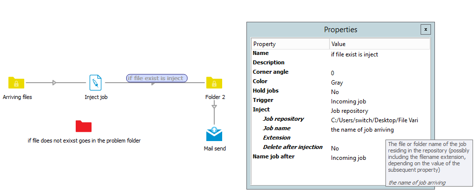

flussidicaio
Posts: 23
Joined: Thu May 03, 2018 6:07 pm
Re: Flow to catch duplicate files
Post by flussidicaio »
with the scripting module it would be easy.
without you can try with "inject job".
See the attached file
