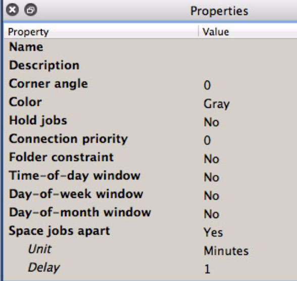

The outgoing connection of the "hold job" has an option "Space jobs apart" which you can set to 15 min.

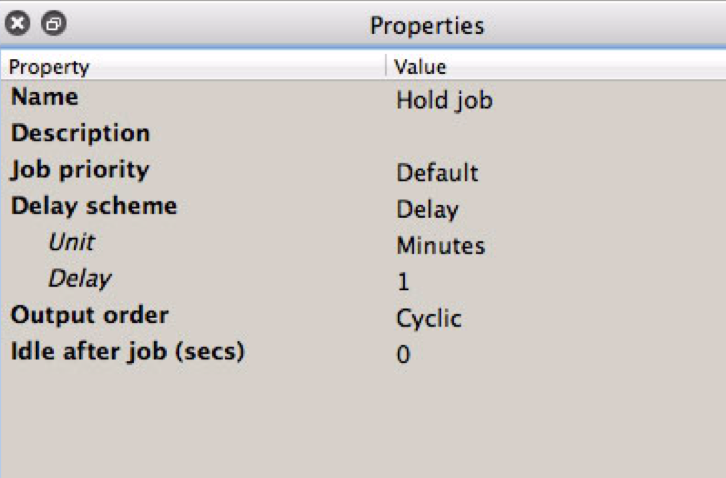

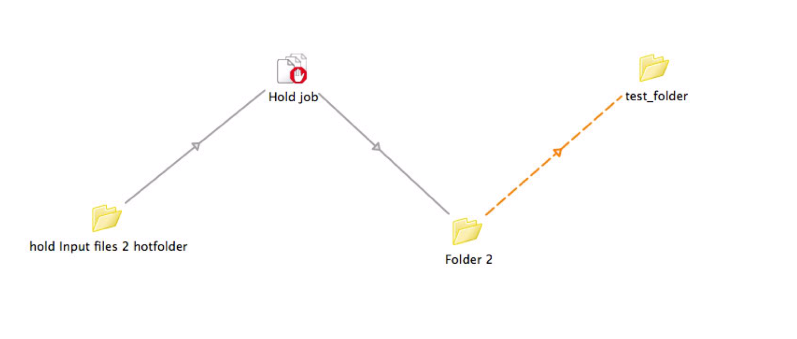

So now I have in the hold jobs element 1 minute delay (for the sake of testing) and in de Space job apart 1 minute
The Workflow as successfully validated and activated but the files do not run from one folder to the other.

Restarted switch and the flow was up-and-running.
Thanks
