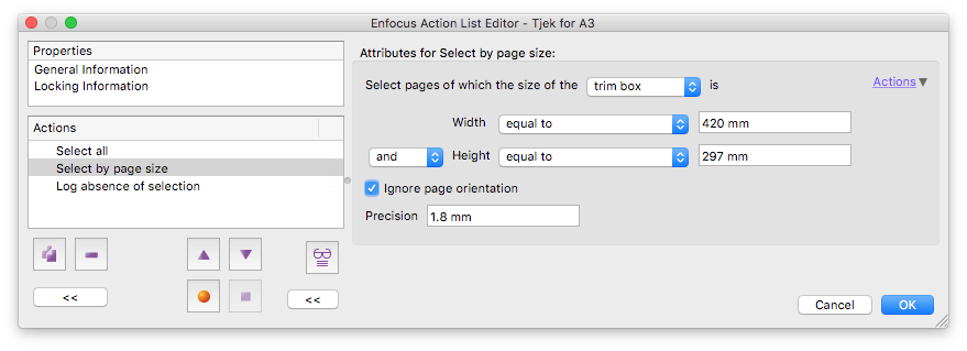

I think you will need to create an action to check this and then include the action in your preflight.
The action could look something like this:
Skærmbillede 2018-06-29 kl. 11.11.21.png (63.66 KiB) Viewed 7196 times
