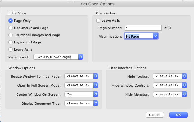

Does it need to be Acrobat Javascript?
PitStop has an action which allows you to change the initial view of a PDF:
http://www.enfocus.com/manuals/Extra/Ac ... _view.html
If you build an Action List with this Action, then you can run it on all your PDF files in an automated way using PitStop Server.
