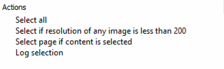

You can create an action to pick up low res per page.
This made need to be extended to report page by page. You can then use the xml for the variables in the email.
