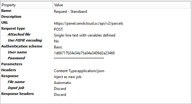

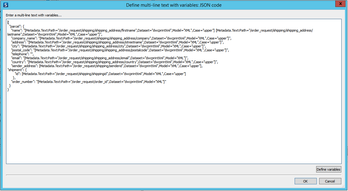

We use the app "Make JSON" and the POST function in Enfocus. I have add some screenshots.
The setting of the POST (HTTP reuest app)

The JSON of the app "Make JSON"
aa
aa
Schermafbeelding 2019-02-27 om 17.18.56.png (60.42 KiB) Viewed 22971 times

Now I’m thinking of it, try this header, might work:
Content-Type: application/json;charset=utf-8

I don'y have the scripting module. I have tested with the header "Content-Type: application/json;charset=utf-8" but that doesn't change anything. Can it be a bug in Switch?
