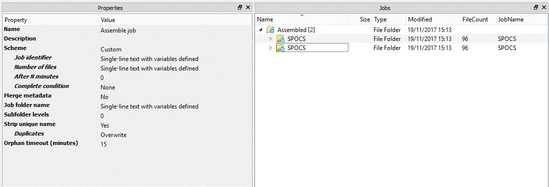

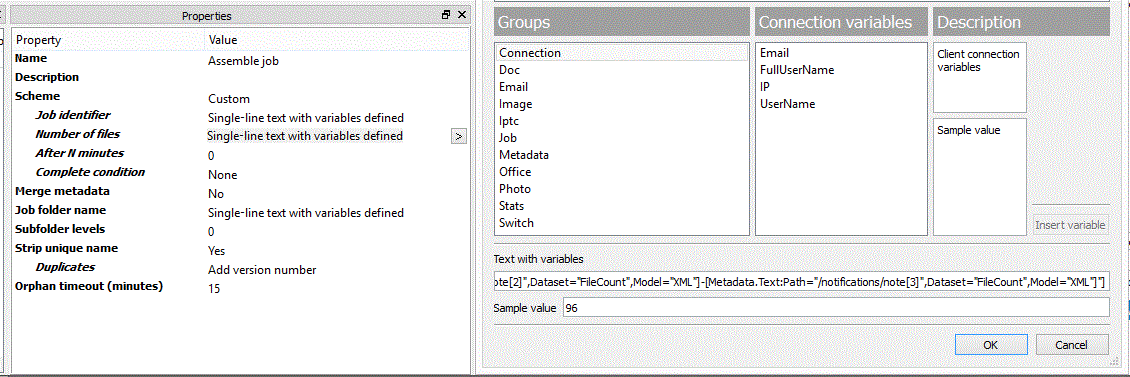

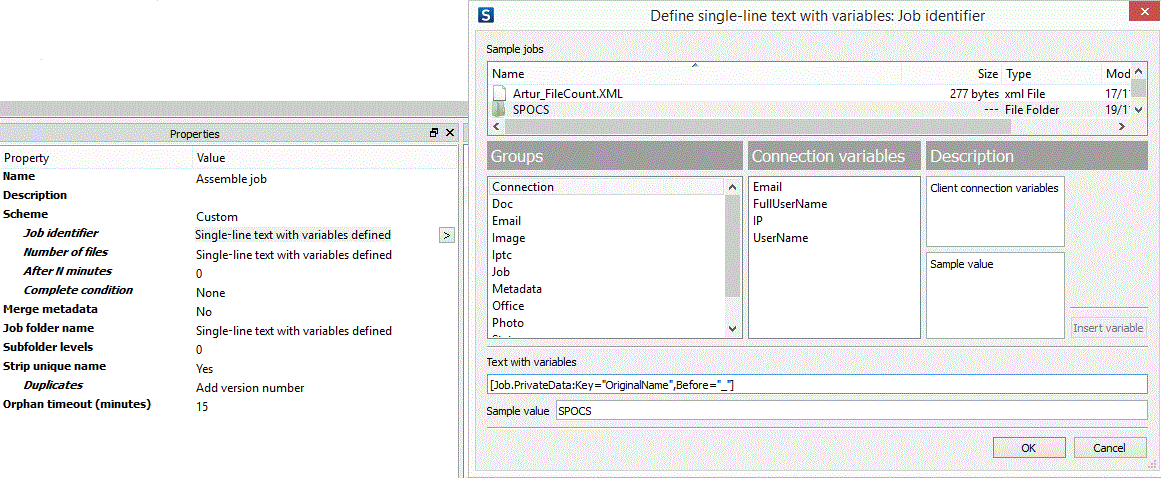

I am getting a weird behaviour of the ASSEMBLE JOB processor, which set-up as per below pics is producing a duplicated job folder, so that I end up with 2 folders of the same name and identical set of files in them, one next to the other. Both on a Success connection. None being the Error out.
It should produce 1 assembled job, should it not ??
Could someone maybe advise on where is the issue and why is it producing duplicates when it should not ??

The folder following the assembler had 2 connections with no filter on them, so ultimately Switch created 2 instances of the job for each flow respectively. Because I put the flow on hold there, those 2 jobs accumulated in one folder creating confusion.
