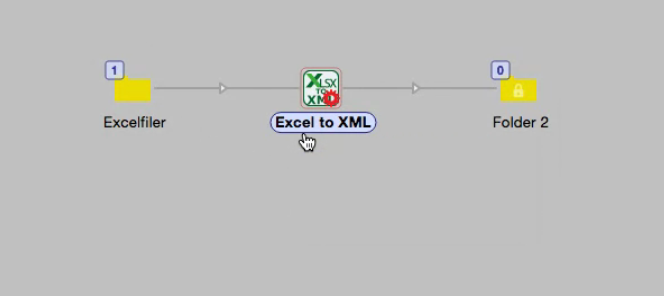

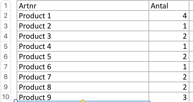

I downloaded a trial of the Excel to XML app from the Enfocus App Store, but even though I'm just playing around with a simple Excel file like this
I get the following error when running this simple flow: Error in line 129 of script: Trying to access undefined member '0'

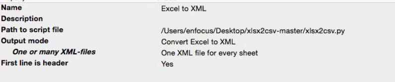

with these settings
Any ideas why this doesn't work?

All looks fine.

I just created that simple trial flow and didn't get further that that. Didn't know what to do when I got that error.

The problem was a corrupt Excel-file that couldn't be converted to XML.
A new version of the app is submitted to Enfocus. This new version will send the job to the Problems job folder.
