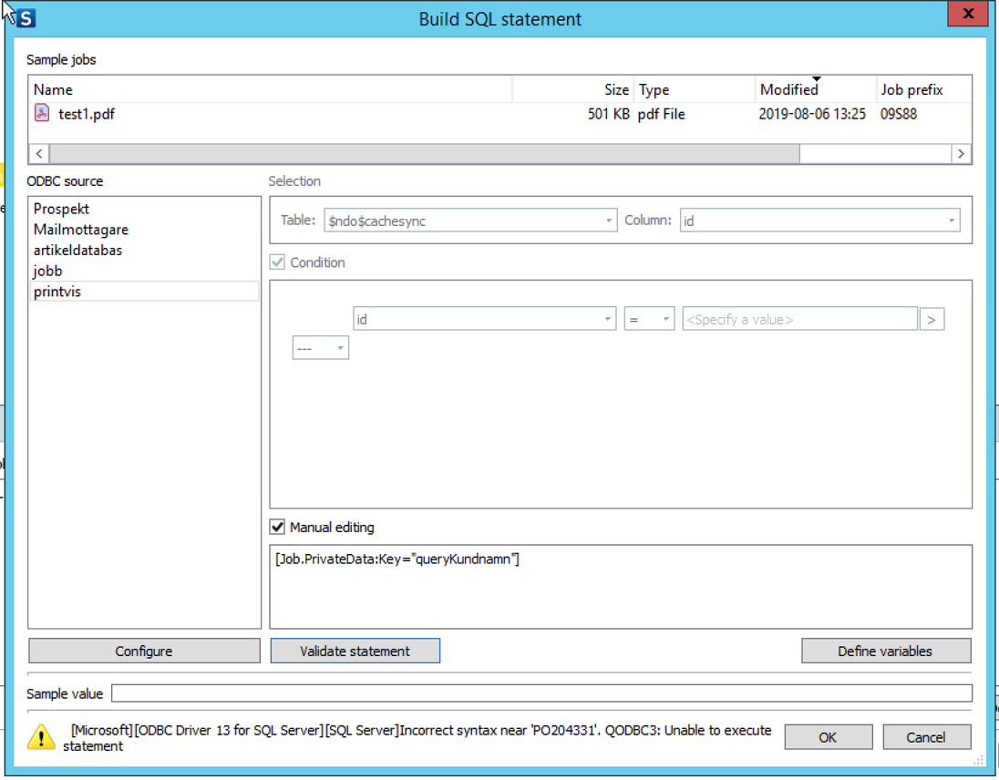

I now have a privatedata variable named "queryKundnamn" that in my example evaluates to:
SELECT "Sell-To Name" FROM "åtta_45$PV Case" WHERE "Order No_" = 'PO204331'
I then insert it to another privatedata variable:
kundnamn=[Database.Text:SQL="[Job.PrivateData:Key="queryKundnamn"]",Connection="printvis"]
I now get the error:
Error in line 1 of script Database.Text: Parse Error: expecting `error' or `'_'' or `';''

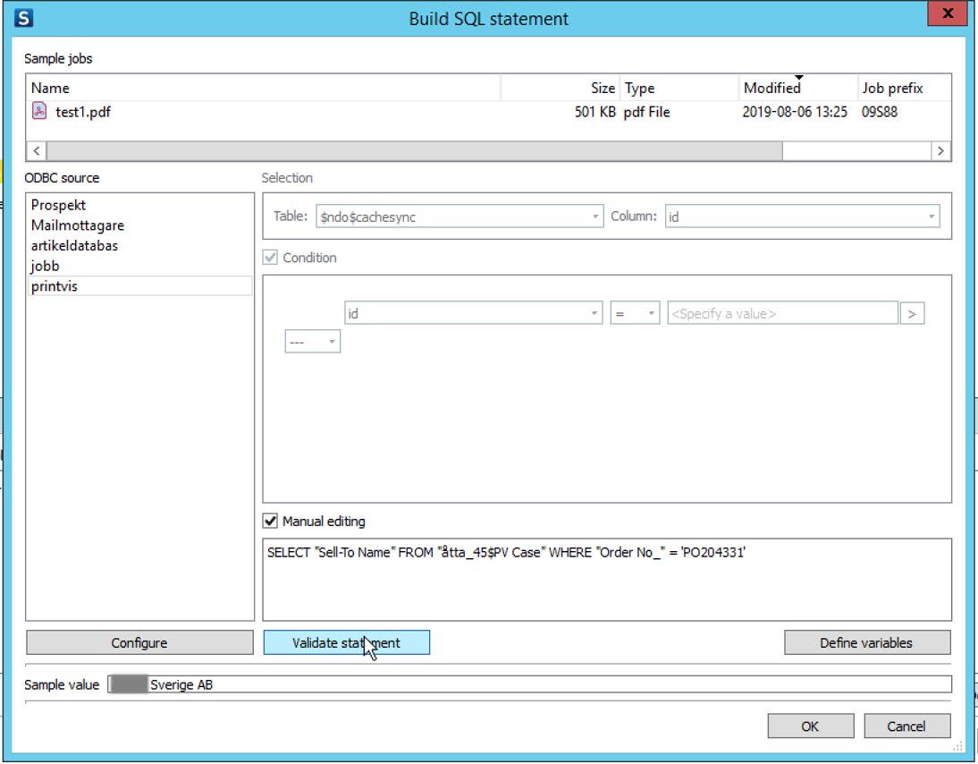

If I try the Query builder again with the string pasted, it works:
If I try inserting the variable "queryKundnamn" into the editor, which evaluates to the same string, it doesn't work:
